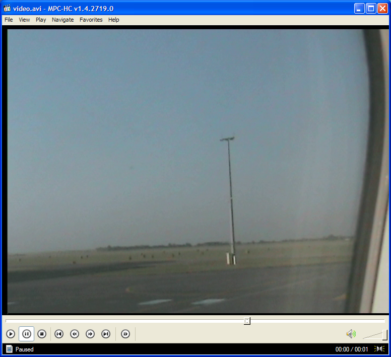

    Hi,
    I made few DVDs of MiniDV camera captured by Exsate DV Capture Live (http://www.exsate.com/products/dvcapture/), made in Adobe Premiere Elements 7. But after few projects, something happens and now all grabbed source videos (avi with dvsd codec) are played with black borders on 3 borders (see picture). I try to change codecs priority and play them with another one (on 3 players), but the result is the same. Source videos (avis) are still the same (file dates are unchanged) and I have no other ideas where to watch now. Do you have any idea? I did take some captured files on other PC, wrong also, but a did not test this before...
    I have Windows XP SP3, DirectX 9c
    Thank you for advice, Fanda

  4. Member edDV's Avatar
    Mar 2004
    Northern California, USA
    Looks like a horizontal shift to the right exposing blanking on the left side. I'd also recommend you capture with WinDV.

    I was testing capturing with WinDV (and Premiere Elements also), but with the same result. Even in capturing realtime thumbnail are borders black.
    Previous projects/videos was made from files I did capture month ago, together with all others (and everything was working perfect). In one day, after 8 hours, Premiere for some time slow down and from this time all players and editors shows borders. It looks like the problem is in directshow or something like that. Sony DV codec shows videos still in the same way...

    Try opening the video in VirtualDub and look if there are borders in your avi.
    You can also re-register windows quartz.dll, just in case something went weird. (regsvr32 quartz.dll)
    And also Windows dv-codec (qdv.dll)

    Nothing of recommended makes any changes. VirtualDub shows borders also. Another codec too. Re-registration was successful, but no change...
