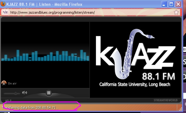

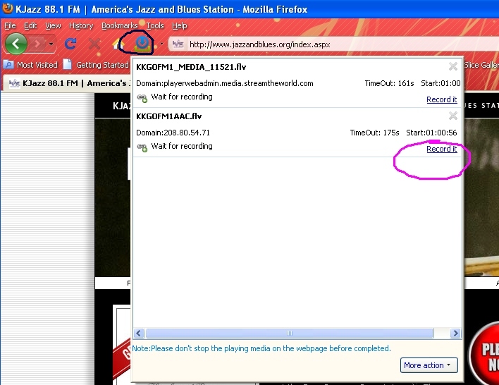

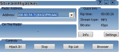

  3. I would like to know how you got that exact complete url (http://208.80.54.71/KKGOFM1AAC)
    because when I play the music stream, the window only shows: 208.80.54.71...
    (See second screenshot, pink circled numbers).
    At any rate, to keep using things that I am familiar with, I just put that above url in StreamHijacker (See third screenshot) and it seem to download the stream (click "Hijack It"). For some reason the file was shown as mp3, but Gspot showed the file as flv. I renamed the file, (just to be clear) and played with vlc.
    I also was able to save the stream from Firefox browser ( see first screenshot).
