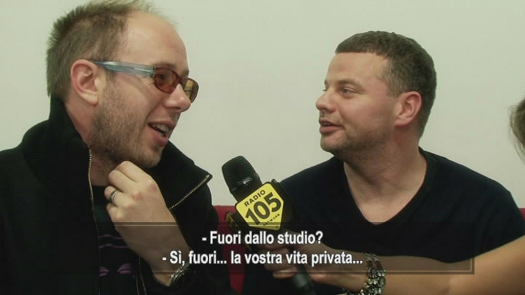

    I wanted to share with you this script I did these days, in order to hardcode subtitles in videos starting from .srt files.
    I know there are plugins or functions which already do this task (TextSub for example), but I had precise needs and I couldn't use it for my task. So I decied to study bit of Avisynth and something else (like GScript etc)...
    Here's what it does: it takes video, .srt file, background image for titles and fuse titles on the video. It can handle collisions e vertical alignment in case of single line title (in my case there aren't subtitle with more than two lines).
    The real deal (I couldn't do with TextSub) was the overlaying the background image only when subtitles are on screen. At the end, something which can look a bit more professional...
    Now the whole workflow is quite faster than doing all the subs in Premiere pasting from a .doc file. Translating in VisualVobSynch is easier when you get confident with it.
    This is how the video looks like after hardcoding...

    The script works fine consider my needs.
    Do you have any suggestion?
    Anyway at the end of the story I have a problem: when VirtualDub encodes the .avs says "out of memory". Do you know why? Where does the code get heavy to run?
