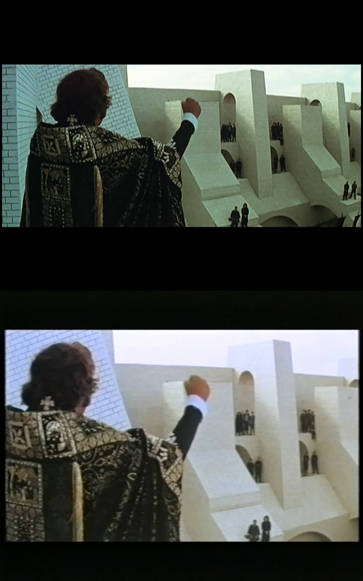

    Maybe it is better to show a sample. The top image is the 2.35:1 source. The bottom image is approx the same frame in the DV source. So you see that both the height and width of the bottom image need to be resized.Click image for larger version

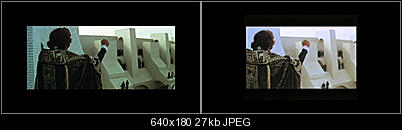

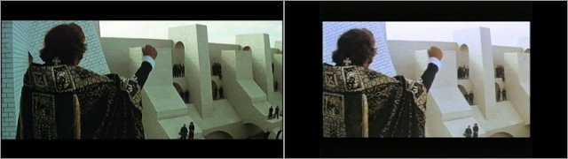

    Ah, I understand. Is this how you want the VHS sourced DV footage to look:

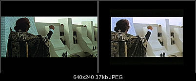

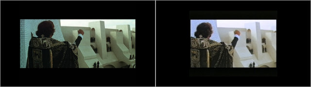

    As you say, you could convert both clips to 16:9 and have the pan&scan footage appear taller and fill the width.
    But, if you do want to keep a common height to both clips, I would suggest working in 16:9. The examples I posted above would look like this on a 16:9 display set to pillarbox 4:3 footage*:
    (*unless the TV has an automatic 'zoom' feature)

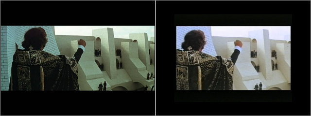

    If both clips were formatted to 16:9 like this:
    it would be better for people with 16:9 TVs. 4:3 viewers with their DVD player set to '4:3 letterbox' would see the same image as the first example I posted.
