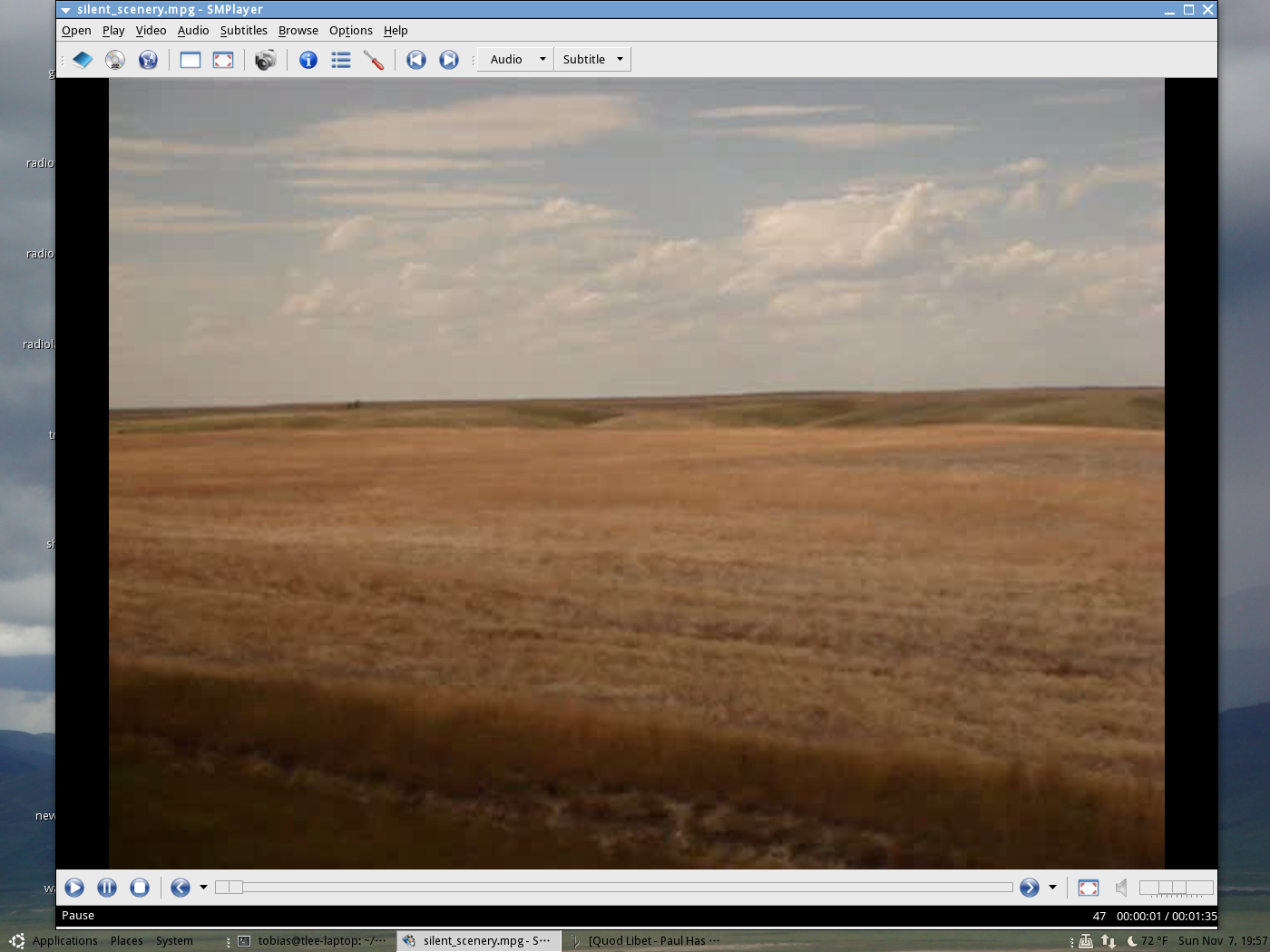

    jagabo: Good to know that about comparing videos. I had been using mplayer and switching between workspaces. Nevertheless, even without simultaneous comparison, the difference is still apparent. I took screenshots of each video (non-simultaneous playback) at the same frame. The HuffYUV image (hhhhhhhh.avi) is definitely better than the MPEG 2 (mpeg2_like_camera.mpg), but it is still not as clear as the original (silent_scenery.mpg). Of course, the original, as you'll see, is not very clear to begin with (it was taken through a dirty window on a train); I certainly don't want it to get any worse.
    One note about the screenshots: they were all taken at frame 47, but for some reason the HuffYUV one is slightly advanced. Not sure why.

  5. The HuffYUV image is more blurry but it isn't exactly the same frame as the original image. Assuming it is representative of the overall video, then the blur is happening before HuffYUV, or possibly during playback. Are you applying any other filters (say, noise reduction) in AviDemux? Did you change the frame size?
    When you provide sample images you should provide them at the frame size of the video, not scaled to full screen or scaled to correct for the aspect ratio. Otherwise you can't tell what artifacts are in the original frame and what artifacts are created by the scaling. Also, with screen caps from a media player you don't know what processing the media player has done. The player may be treating different sources differently. VirtualDub is good for examining video files (it displays them onscreen pixel-for-pixel by default) and making snapshots.
    I just tried using AviDemux to convert the sample file I linked to earlier. The program appears to be performing some deblocking or noise reduction of MPG sources. I think that is what's causing your problem, not the HuffYUV compression.
    Yes, here it is: In AviDemux select Edit -> Preferences, then go to the Video tab. Disable Horizontal and Vertical Deblocking, and Deringing. You may have to exit and restart the program for the change to take effect. Assuming that clears up your videos, go back and enable those options but change the strenth. Some deblocking is usually helpful -- and your source is pretty blocky.
