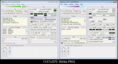

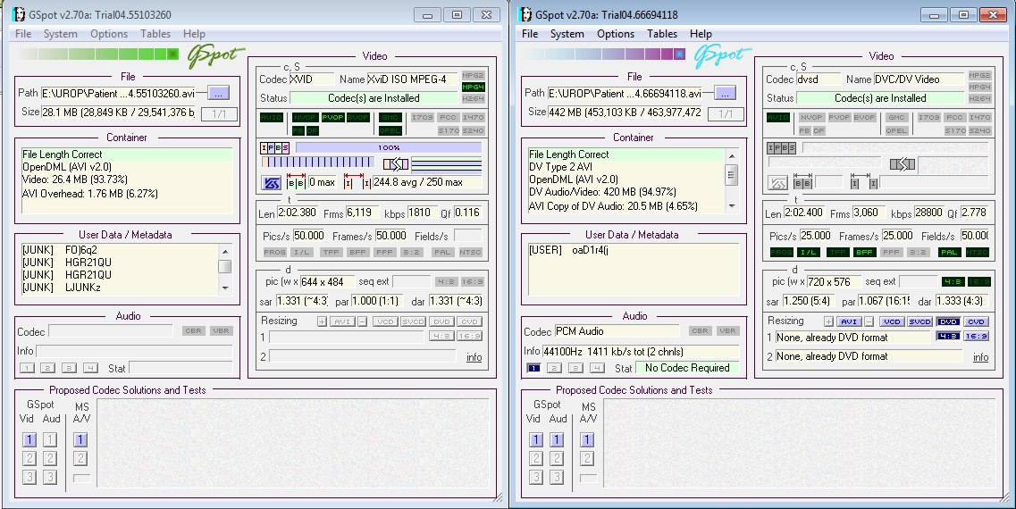

    Here's a screenshot of the videos' specs. Consider that the two high-speed cameras produce videos like on the left, and the DV camera's video is on the right.
    Size-wise, the high-speed camera videos are less than 10% each of the size of the DV, which never really exceeds a couple GBs (these are all very short clips).
