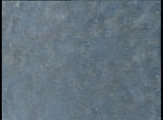

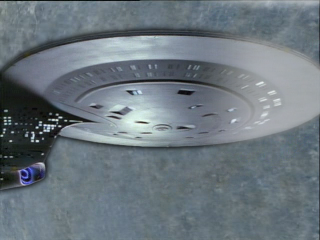

  1. Alright. I have this Star Trek footage, and what I am trying to do is insert a video of the Enterprise-D on top of a background. When I tried the easiest approach, chroma keyer set to black to match the black stardrop background, the result was absolute crap, as I expected. A different approach I am trying seems to working out better, but still has problems, hence the reason for this post. Here are the steps taken:
    - Here is the background:
    - I then cropped the video of the Enterprise to minimize the amount of black and added it to a track above the background track:
    - I then duplicated the Enterprise footage and placed it on another track above. With filters I was able to make the Enterprise shape in the footage green:
    - I then added a green chroma key mask:
    - And this is how far the result has gotten:
    Now, I was hoping I could set Vegas to use the green Enterprise footage as a sort of mask, where everything that wasn't green would be cut out, but I'm uncertain how this could be done.
    I am using Vegas Movie Studio 8.0c on Windows 7 x64.
    Any ideas?
    Thanks.

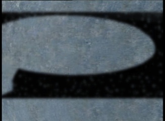

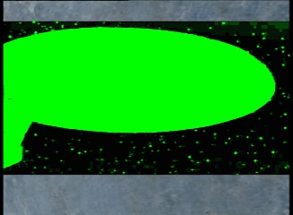

  2. Now, I was hoping I could set Vegas to use the green Enterprise footage as a sort of mask, where everything that wasn't green would be cut out, but I'm uncertain how this could be done.
    You're going to need a better matte , there are too many holes and it's going to look like crap. Vegas really isn't the best tool for this job, but it is possible to use green for the matte
    Top track = your matte (your green footage)
    2nd track = video clip
    3rd track = background
    Hit the track fx button on track 1 => mask generator tool => for 'type' select green instead of luminance . You can hit "invert" if you want green areas to show through or vice versa
    On track 1, push "compositing mode" button and select "multiply (mask)"
    On track 2, push "make compositing child" button

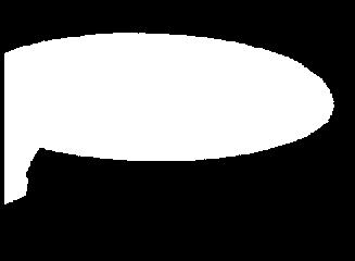

  5. He's asking about using mattes, not keying . He's only using the color key to generate the matte.
    The problem in his case is the matte, there's too many holes. I've attached what a "proper" matte would look like in green, luma, and the end effect in vegas
    Normally, people that use compositing mattes use luma or black/white and greyscale. You can invert the matte
    (either white is transparent, or black is transparent) . It's also possible to use other colors (green is
    transparent , as is the case here)
    You can't color key this shot effectively because of the black background, and black in the enterpise, or you'll be left with holes in the enterprise. It's the same idea as green spill on typical green screen shots - your foreground subjects have holes in them
    Certainly rotoscoping or using bezier masks manually is one way, but that is very tedious to do in vegas when you do it frame by frame . If you can generate a clean matte with a few filters as he's trying to do here, it is a lot faster and easier
    Other specialized tools dedicated to compositing make this job easier, they have rotobrush tools (that automatically track forwards and backwards instead of roto frame by frame) , matte generation tools , special mask tools , mask feathering, light wraps, etc....
    Image Attached Images

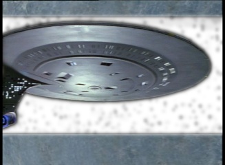

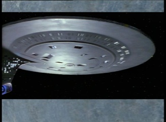

  8. Thank you so much poisondeathray for the solution in your second post!
    I vaguely remember reading something similar to the instructions you wrote, but I totally forgot it.
    The end result doesn't look that bad, except for the black lines on the top and bottom due to blurring.

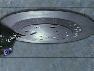

  9. The end result doesn't look that bad, except for the black lines on the top and bottom due to blurring.
    Why do you have the edges?
    Make your matte the same size as all the other layers (make all the layers the same size and don't do that initial crop step):

  11. Why do you have the edges?
    Yeah, I figured shortly before you posted. I actually only had to resize the "green screen" layer. I need to keep the other layer as is so to minimize the appearance of "black stars".
    Here is the near final result:
    The whiteness is intentional, as it is part of an overall effect.
    Thank you so much for your help!

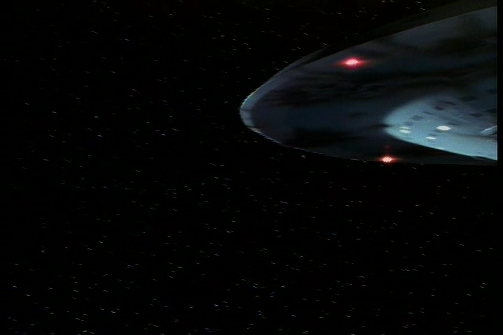

    Actually, it was an accident, more-or-less. I was trying out various filter seeing if I could increase the contrast between the Enterprise and the space background (this being original footage) so I could chroma-key the black background easier. By chance, I found a filter which turned the brighter points of the footage green, and I decided then to change my approach.

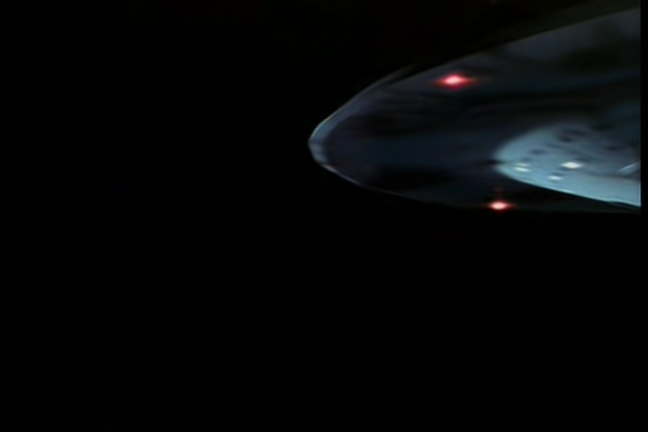

  22. Continuing on, I would now like to remove as much of the "black stars" as possible. I was thinking of using a combination of the cookie cutter videoFX and the pan and crop tool. However, it seems I have to apply the videoFX to the entire video when I only want it to appear at certain times in the video footage. I know I can add tracking to both the Cookie Cutter and Pan and Crop, but this causes the effect to move in a path on screen rather simply appear and disappear/instantly change when I want them to without having a transition. Am I able to do this? Or is there perhaps an easier way to remove the "blemishes"?
  23. The "black stars" are from holes in your matte
    Your real question is how could can you generate a clean matte in vegas, short of some manual roto work
    I don't know - I would use after effects for this . AE CS5 has a rotobrush that automatically does selections (similar to magic wand in photoshop), except it tracks fwd/bwd for video. It reduces the amount of manual rotoscoping time immensely
    If you were approaching it this way, what you would want to do is keyframe the mask path and mask shape (so it changes shape frame by frame) . Vegas sucks for this type of work
    EDIT:
    One approach you could try, is apply a heavy denoiser to obliterate the stars when generating your matte (it doesn't matter that it blurs the detail of the enterprise, it's only the shape for the matte that you want) , then use whatever filters you used to generate the matte in the 1st example. That should reduce the amount of manual work you have to do. You really only need a rim around the ship, the rest can be done with a garbage matte

  25. The "black stars" are from holes in your matte
    Indeed.
    Unfortunately, I don't have After Effects.
    It's a six second clip, so going frame-by-frame wouldn't be a huge issue. The problem is that I can't just have a cookie cutter effect appear on a specific frame. Vegas tries to render this as motion (have the effect move in a smooth path around the video) and I don't want that. I just want it to take effect in one frame and not appear in any other frame at all. Same with pan and crop. I don't want a transition between the different sizes. I just want the changed crop sizes to appear in one frame and not be a transition. However, your second solution may save some time:
    Worth a try. However, what filter/setting in Vegas would be equivalent to a "heavy denoiser"?

  26. Originally Posted by Morality124 View Post
    vegas doesn't come with any worthwhile denoisers
    you can use avisynth or virtualdub - free and dozens of filters and all are fully customizable
    e.g.
    AVISource("video.avi")
    source = last
    vectors = source.MVAnalyseMulti(refframes=3, pel=2, overlap=4, sharp=1, idx=1)
    source.MVDegrainMulti(vectors,thSAD=2000,idx=1)
    fft3dfilter(sigma=12,sharpen=0.2)
    Notice how blurry enterprise is after applying heavy filters - but it doesn't matter for this purpose, all you need is the shape outline for the matte
    So once, you "cleaned up" the stars for a preprocessed clip, then you could use whatever you did to generate the matte in the 1st post. Also don't crop it or you'll get the horizontal lines.
    You may have to do a tiny bit of roto work, in sections where there is contiguous black (where the area of 'space' overlaps with the enterprise outline), but it will depend on what technique you choose for isolating & generating masks
Name:	0 original.png
Name:	1 denoise.png
