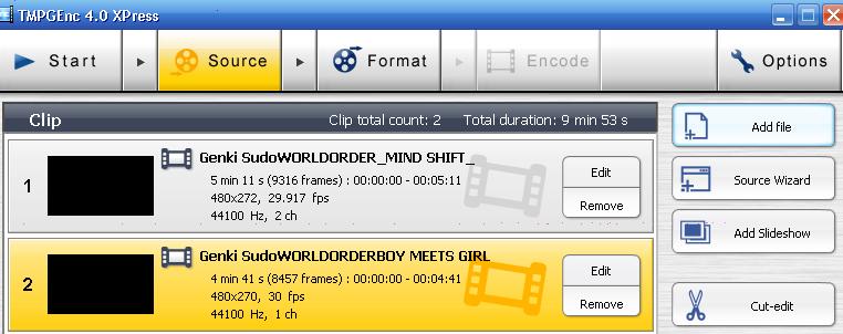

  2. TMPGEnc XPress to cut and edit avi,convert to mpeg 2 . Convert mpeg2 in TMPGEnc DVD Author 3 (payware)
    load avis..then choose the cut edit tab
    https://forum.videohelp.com/images/imgfiles/oKSQu.jpg
    use slider to choose start and end cut point
    https://forum.videohelp.com/images/imgfiles/FH58w.jpg
    Or load avi in virtualdub to do your edits guide http://www.weethet.nl/english/video_cutavis.php ..then convert in dvd authoring program ..Favc,Avi2dvd,Dvdflick (all Freeware)
