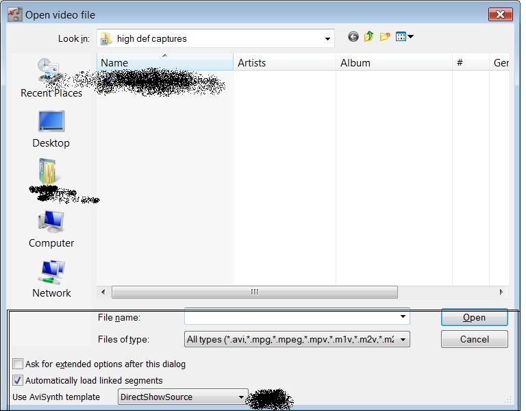

    Use the avisynth template - directshowsource and select "all files" in the file type and you'll be able to open the file without a problem in virtualdubmod. I'm sure the same procedure can work in other variants of virtualdbub but I can do this in vdubmod with my files from my hdpvr. I record in m2ts mostly (but you can record in ts or mp4 but they will all use h264 for the actual video inside the files).
    Also for simple cutting and quick authoring the arcsoft software that comes with it is decent enough.

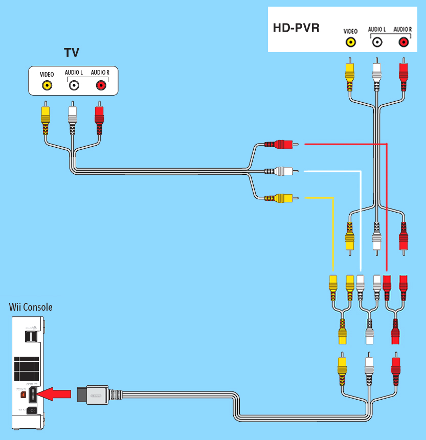

  19. I see what you mean, but there is only 1 slot on the back of the Wii for the plug of the other end of the composite or component, whichever you choose. But I thought of something. My current (bad) capture card has composite cables from the capture card to the TV, and the capture card basically captures the TV picture, not necessarily my Wii directly. Do you think I could use these composite cables plugged into the composite on the front of the HD PVR and connect the other end to my TV to record that way? Can it record that way?
    Nov 2002
    You'll have to use RCA splitters. If you can't find the correct splitters then you'll need to use couplers to join the spliters and RCA patch cords.

  22. >DarellS
    That picture makes complete sense to me. I guess I would need to buy 1 RCA for each color (seeing the picture of an actual one jagabo posted), and 1 more composite cable that would go from the HD PVR to the other RCA slot. (Putting the HD PVR composite cables in the video slot I'm sure would not work).
    Seeing as those RCA adapters are so inexpensive (only 1 buck a pop) it would be a very very easy investment. I'm just thinking if I would need to buy anything else besides this with my HD PVR when the time comes.
