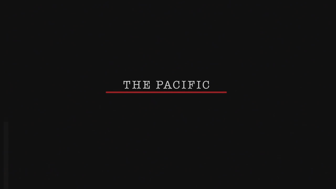

    I have problem with x264. When I try to encode video with it, one dark scene get's artifacts that are very annoying and I have no idea on how do remove them. The avs script is plain simple - the source and resize (lancos sharp). So far I have tried disabling AQ, lowering AQ strength, lowering PSY-RD and PSY-trells strength and still nothing. I'm using MeGui for encoding. here is my current command line that MeGui shows me:
    program --level 4.1 --preset slower --tune film --pass 2 --bitrate 2000 --stats ".stats" --min-keyint 23 --chroma-qp-offset -3 --vbv-bufsize 50000 --vbv-maxrate 50000 --cqmfile "C:\Program Files\MeGUI\extra\eqm_avc_hr.cfg" --output "output" "input"
    And this is Mediainfo
    cabac=1 / ref=8 / deblock=1:-1:-1 / analyse=0x3:0x133 / me=umh / subme=9 / psy=1 / fade_compensate=0.00 / psy_rd=1.00:0.00 / mixed_ref=1 / me_range=16 / chroma_me=1 / trellis=2 / 8x8dct=1 / cqm=2 / deadzone=21,11 / fast_pskip=1 / chroma_qp_offset=-5 / threads=3 / sliced_threads=0 / nr=0 / decimate=1 / interlaced=0 / constrained_intra=0 / fgo=0 / bframes=3 / b_pyramid=2 / b_adapt=2 / b_bias=0 / direct=3 / weightb=1 / open_gop=0 / weightp=2 / keyint=260 / keyint_min=20 / scenecut=40 / intra_refresh=0 / rc_lookahead=60 / rc=2pass / mbtree=1 / bitrate=2700 / ratetol=1.0 / qcomp=0.60 / qpmin=10 / qpmax=51 / qpstep=4 / cplxblur=20.0 / qblur=0.5 / vbv_maxrate=50000 / vbv_bufsize=50000 / ip_ratio=1.40 / aq=2:1.40 / nal_hrd=none
    And finally, in attachments there are pictures of the artifacts that I can't get rid of.
  2. what happens if you don't use cqm?
    are the artifacts visible before encoding in avs preview ?
    for the other dark scenes, 2000 is quite low bitrate for 1280x720 - it might not be enough . What do the other artifacts look like?

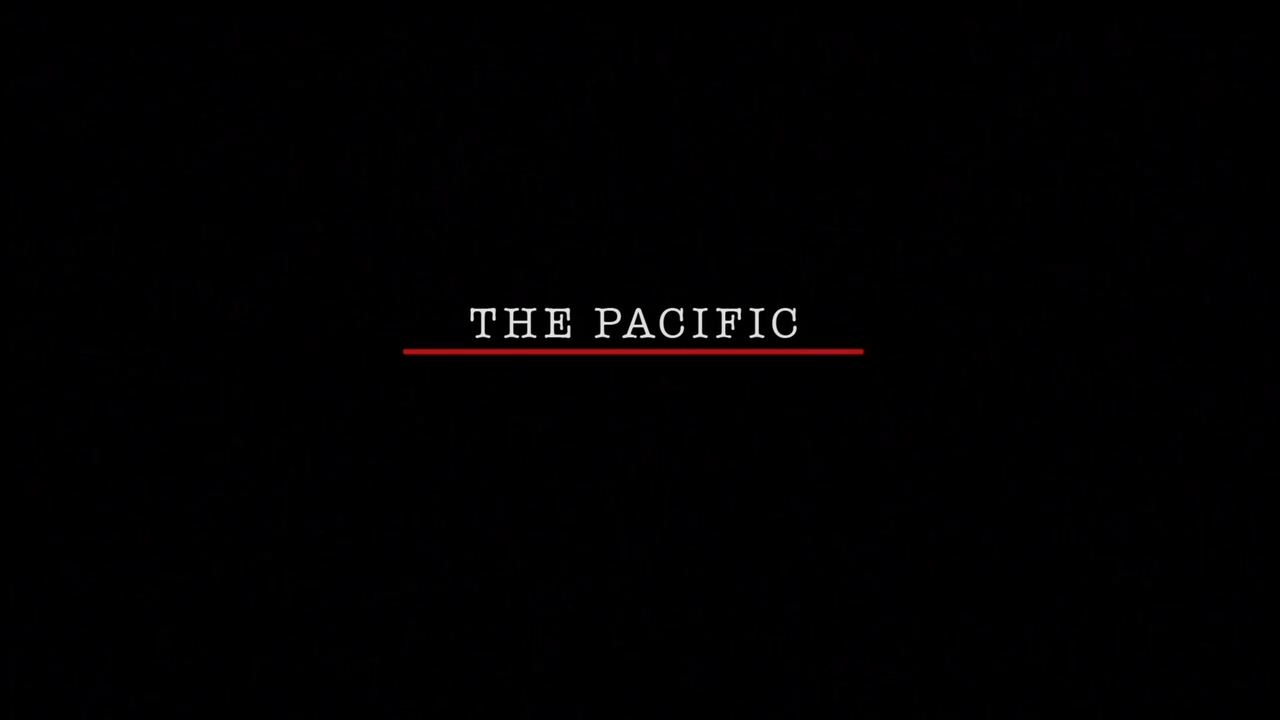

    Ok, I removed CQM and new command line that MeGui shows me is
    program --level 4.1 --preset slower --tune film --pass 2 --bitrate 2700 --stats ".stats" --min-keyint 23 --chroma-qp-offset -3 --vbv-bufsize 50000 --vbv-maxrate 50000 --aq-mode 2 --output "output" "input"
    and Mediainfo shows this info
    cabac=1 / ref=8 / deblock=1:-1:-1 / analyse=0x3:0x133 / me=umh / subme=9 / psy=1 / fade_compensate=0.00 / psy_rd=1.00:0.15 / mixed_ref=1 / me_range=16 / chroma_me=1 / trellis=2 / 8x8dct=1 / cqm=0 / deadzone=21,11 / fast_pskip=1 / chroma_qp_offset=-6 / threads=3 / sliced_threads=0 / nr=0 / decimate=1 / interlaced=0 / constrained_intra=0 / fgo=0 / bframes=3 / b_pyramid=2 / b_adapt=2 / b_bias=0 / direct=3 / weightb=1 / open_gop=0 / weightp=2 / keyint=250 / keyint_min=23 / scenecut=40 / intra_refresh=0 / rc_lookahead=60 / rc=2pass / mbtree=1 / bitrate=2700 / ratetol=1.0 / qcomp=0.60 / qpmin=10 / qpmax=51 / qpstep=4 / cplxblur=20.0 / qblur=0.5 / vbv_maxrate=50000 / vbv_bufsize=50000 / ip_ratio=1.40 / aq=2:1.00 / nal_hrd=none
    x264 version is 1745-1 (Jeep) and no, these artifacts are not there before.
    Still artifacts like seen on attachment.
    I have seen artifacts mostly on one scene only - the title scene like seen on screens. everything else looks good.

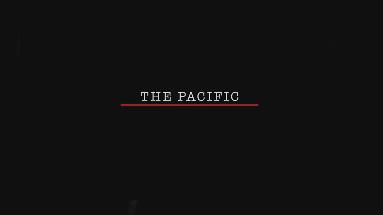

    I use KMPlayer and I pause the video and use snagit to take the picture. The picture I upload here shows the SAME thing as I see in video.
    I use VMR9 Renderless. But when I switched between Haali and other I can still see the artifacts. What decoder You recommand?
  6. It's not a renderer issue
    Some older decoders had problems decoding weightp (it's enabled in your settings) , newer ffdshow build, or internal mpchc should have no problems
    If you check with mpchc internal decoder, and problem still is there, then it's something else (or encode with --weightp 0)
    It might be jeeb's build, try generic build x264.exe from x264.nl (just drop in the replacement, but backup your old x264.exe if you want to keep it)
    http://www.x264.nl/

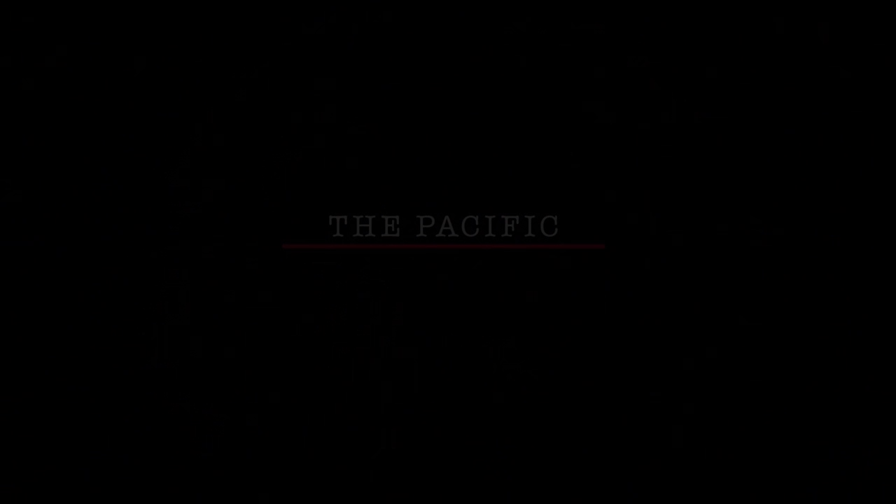

    Using MPCHC I can't see the artifacts anymore altho the video is all hmm... line'ated - almost like noise but instead of pixels there are lines. So this IS a KMPlayer's fault.
    1st - MPCHC 2nd - KMPlayer

  12. But how come KMPlayer shows the artifacts and MPCHC doesn't?
    They are using different decoders
    The main difference in the black level is the renderer . You said you were using vmr9 renderless for kmplayer - that will give you the washed out look
    You are probably using overlay mixer for MPCHC, check to settings to be sure
    For KMPlayer, you can change the decoder to something else in the settings

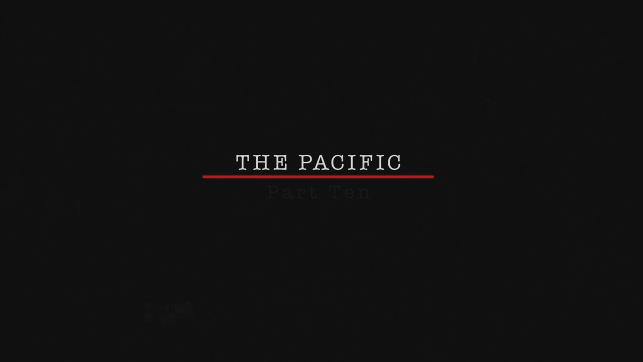

    Now, what setting should I alter to make the gray pixels disappear? - the gray pixels can be seen on attachment.
  17. You need to get your display calibrated. The background is a mix of zeros and ones. On a properly calibrated monitor you shouldn't really be able to tell the difference.
  18. leave chroma-qp-offset default, and aqmode default , you can disable mbtree as well (mbtree tends to make fades worse) . If you want to keep mbtree, try increasing qcomp
    This is a fade in or out, so you might benefit from using a build with the fade compensation patch
