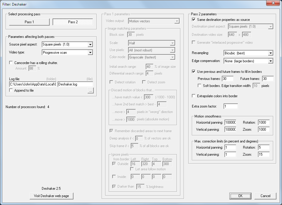

    sorry for the confusion. It was a deshakered clip of the show's credits. I removed it since I figured out how to fix it. Video was zooming in/out. I guess the mostly black background with odd white shapes moving around caused problems. Havent had that issue elsewhere yet. Reducing Pass #2 Max Correction limits (horizontal/vertical) from default 15 to 1 will fix it, which I will redo later.

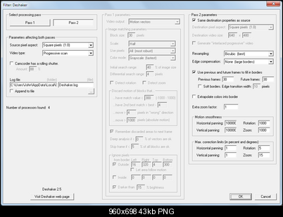

  8. Here's a version that was deshaken using only the top left corner of the frame as a reference. I think this gets rid of the motion you are complaining about:
