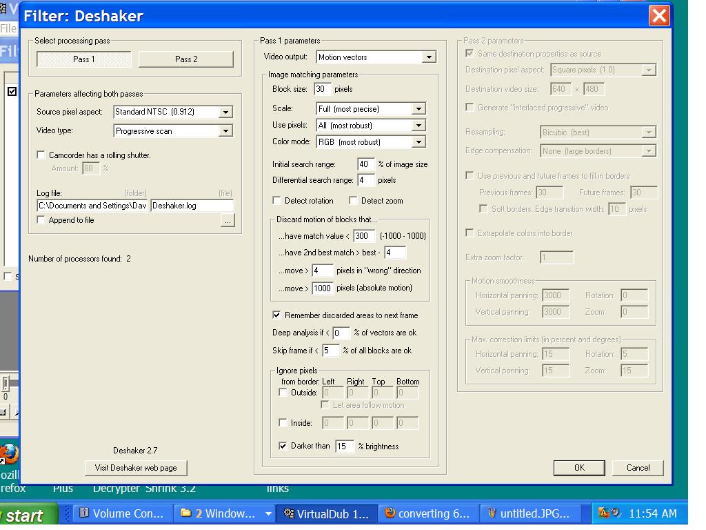

    I'm finally getting to this jumpy video (2.m2v). Poison, do you recollect what settings you used for Deshaker? I did a sample following an online guide, and set the rotation/pan to 0 in Pass2, but still got and moving borders, and video still looked bad.
    Also, I read an uncompressed avi output can be 90 gigs per hour. What codec would produce the smallest lossless video? Would that be UT video 420 you recommended in another thread? Does that need to be configured when chosen?
  4. Originally Posted by spiritgumm View Post
    detect rotation, detect zoom should be uncheckmarked in pass 1 parameters
    The scale and pixle options below will be slower but more accurate. You can skimp on these options, but the results might differ a bit.
    scale: full (most precise)
    use pixels: all (most robust)
    On pass 2 parameters , in post #59 , I said "I used adaptive zoom and no borders, but you might prefer the other border options like mirror or fill in with past/future frames "
    Also, did you read that entire post regarding dupes and srestore placement order in the script ?

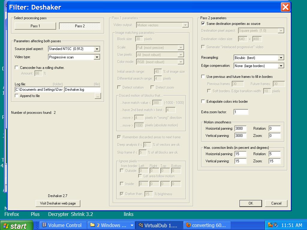

    the online guide (out of date) specified scale=full, and pixels=all, so I did do that.
    I added 0 in the zoom/rotation in Pass 2 (to mimic your "deshaker(norotation.nozoom).xvid.q3.avi" video), while increasing the other parameters to 3000 (suggested in guide). Here's pics of my 2 pass settings, hopefully you can identify my mistakes.
    I dont know what part of the script you kept/omitted while using Deshaker. I tried a basic script, omitting Depan and Stab to see if Deshaker would replace their functions. Omitted noise reduction to get a faster sample done:
    assumetff
    bob()
    SRestore(23.976)
    trim(25571,25983)
    The result had moving borders, and vertical shaking that Stab might correct.

  6. your pass 2 settings say: edge compensation none (large borders)
    large borders mean large black borders. If you re-read my post, it says I used "adaptive zoom (no borders)"
    no borders means.... no borders . The trade off is you lose pixels. It zooms in , so you lose active image area.
    I deleted everything and don't recall what I used before deshaker, but it was probably something like this
    If you asked back when this was posted I would have posted the exact script
    MPEG2Source()
    AssumeTFF
    QTGMC() #some settings don't recall . You can use some other bobber here
    Srestore(23.976)
    AssumeFPS(24000,1001)
    I may have cropped some of the borders horizontally (keeping mod16) before bobbing, and after bobbing cropped vertically, for slightly faster processing. I probably split that into a lossless 1st stage (video=>fast recompress in vdub, some lossless codec), then used something like this for the input into deshaker
    AVISource("1stpass.avi")
    Crop() #can't recall exact values
    ConvertToRGB()
    Deshaker works better when you don't have black borders to begin with. I can't recall what the exact crop values were
    Then run that in deshaker, export out lossless RGB
    Then clean it up with other denoising filters, and resize (and or add borders if you're going back to dvd). I think I used RemoveDirtMC
    AVISource("deshakerRGB.avi")
    ConvertToYV12()
    #some noise filters
    #some resize or add borders

    I got mixed up - thought I would get 'no borders' (none) when I picked "None [Large borders]."
    With Deshaker 2.7, the wording is slightly different. There is no "Adaptive zoom (no borders)." Options are:
    None (Large Borders)
    Adaptive zoom (some borders)
    Adaptive zoom only
    Fixed Zoom (no borders)
    Adaptive and Fixed (no borders)
    Adaptive and Fixed only
    I would think "Adaptive zoom only" would be what you're suggesting - "Adaptive zoom[no borders]", but if that were true, the last two options should be the same (therefore redundant). So something is amiss.
    I will be encoding to dvd, so I would add borders later. With Stab and DePanStabilize, I cropped afterwards, but I will crop before bobbing and deshaking. I originally used BOB (and cant realistically use Qtgmc with my PC).
    Why do I need the line: AssumeFPS(24000,1001) ?
  8. I think it was Adaptive and Fixed (no borders)
    There might be better options, like the edge fill options. You can experiment with them
    23.976 is only an approximation ; 24000/1001 is the exact value (more correct). I don't know if srestore frate parameter accepts fractional input

    I finally started the two videos I need to deshake. As predicted, it's taking alot of time and space, so I'm doing it in small increments. Have had at least two problems so far:
    A fast moving car moving left to right, kept relatively in center screen by camera panning right to follow, has some horizontal jerks in it.
    The other problem (artsy opening credits were zooming in/out instead of staying static) I can eliminate by reducing the Max Correction limits (horizontal & vertical) from 15 to 1 in Pass#2. Does not help with the first issue.
    Also wondering if I should encode the short lossless AVI files to dvd as I go, or wait until they're all done, and combine together in an AVS and encode as one complete episode? Will be using 2pass in HCenc.
  28. Originally Posted by spiritgumm View Post
    The other problem (artsy opening credits were zooming in/out instead of staying static) I can eliminate by reducing the Max horizontal & vertical smoothness to 1 in Pass#2. Does not help with the first issue.
    What does the original look like ? Do you even need deshaker for this bit ? Maybe process it in segments (eg. use different settings for the credits)
    You can try disabling zoom in the detection pass
    If you have enough HDD space, I would do 1 episode in HCEnc
  29. Member spiritgumm's Avatar
    Jan 2004
    Thanks for the dvd encode suggestion. I'll just have to make room on HD.
    I still have the first video I did with Depan and Stab, and the brief car shot is fine in it. After I mux the audio into each version, I'll edit together the best shots from each in VideoRedo. And add any re-done clips like the credits.
    I originally de-activated the zoom/rotation settting in Pass#1. I reactivated it to see if that would help with two problems, but didnt work.
