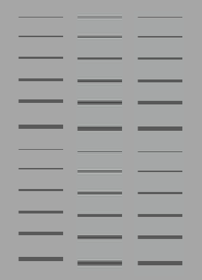

  15. The problem with SeparateFields().resize().Weave() show up on sharp horizontal lines and edges:
    On the left is the original. The middle is resized after SeparateFields. On the right is resized after Yadif().

    Huh. Is there a term for that halo effect? I hope you didn't do all the work to make that comparison just for me. You know I'll always defer to you guys' advice.
  17. Originally Posted by spiritgumm View Post
    The oversharpening halos are from Lanczos4Resize(). It's a sharpening resizer and gives halos like that if the material is already very sharp. You can avoid the halos by using BilinearResize() instead:

  19. The problem isn't just halos. Look at the BilinearResize versions. Sometimes the lines are doubled (see the topmost line), overall they're blurrier.
    If your video isn't so sharp you won't get much haloing from the sharpening resizers. That's why I didn't simply tell you to use BilinearResize. You have to decide for yourself which works better with your videos. I'm showing you what to look for.
