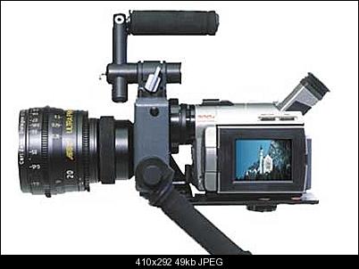

    At your budget, a used premium MiniDV camcorder is your best bet but I'm not sure there is much choice in Romania. You may need to use eBay to reach into western Europe. Condition is important. Most have low use but a few were dropped or run to the point of wearout. Maybe there is a second hand dealer that will certify a used model.
    You won't find one at your price point that takes interchangable camera lenses but adapter kits exist. Problem is these exceed your budget.
    For example
    http://owyheesound.com/anamorphic.php
    http://www.thecameradept.com/equipment/17-lens-converters/items/82-ps-technik-mini35-d...sony-ex1-to-pl
    http://www.dvinfo.net/canon/images/images15.php

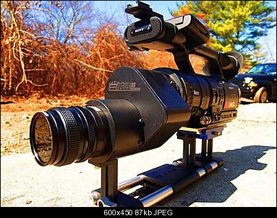

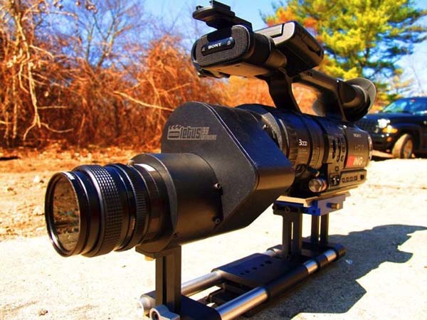

    Target Europe, Australia and Asia for used PAL camcorder models.
    The most popular 35mm lens adapter is Letus. Too bad they sell for $1000.
    http://www.letus35.com/cart/Letus35-Extreme.html

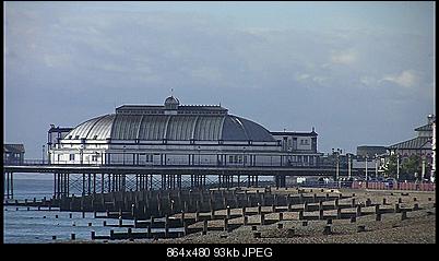

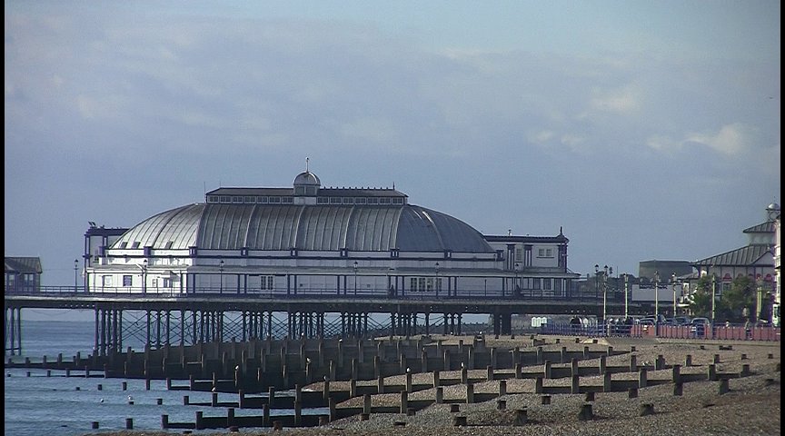

    and how is the quality of the SD output comparing to the original HD one.
    This is downconverted to 'ffvhuff' 854x480 resolution and sharpened (it had to be padded to 864x480 to work properly with my video editor):

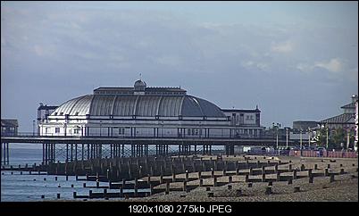

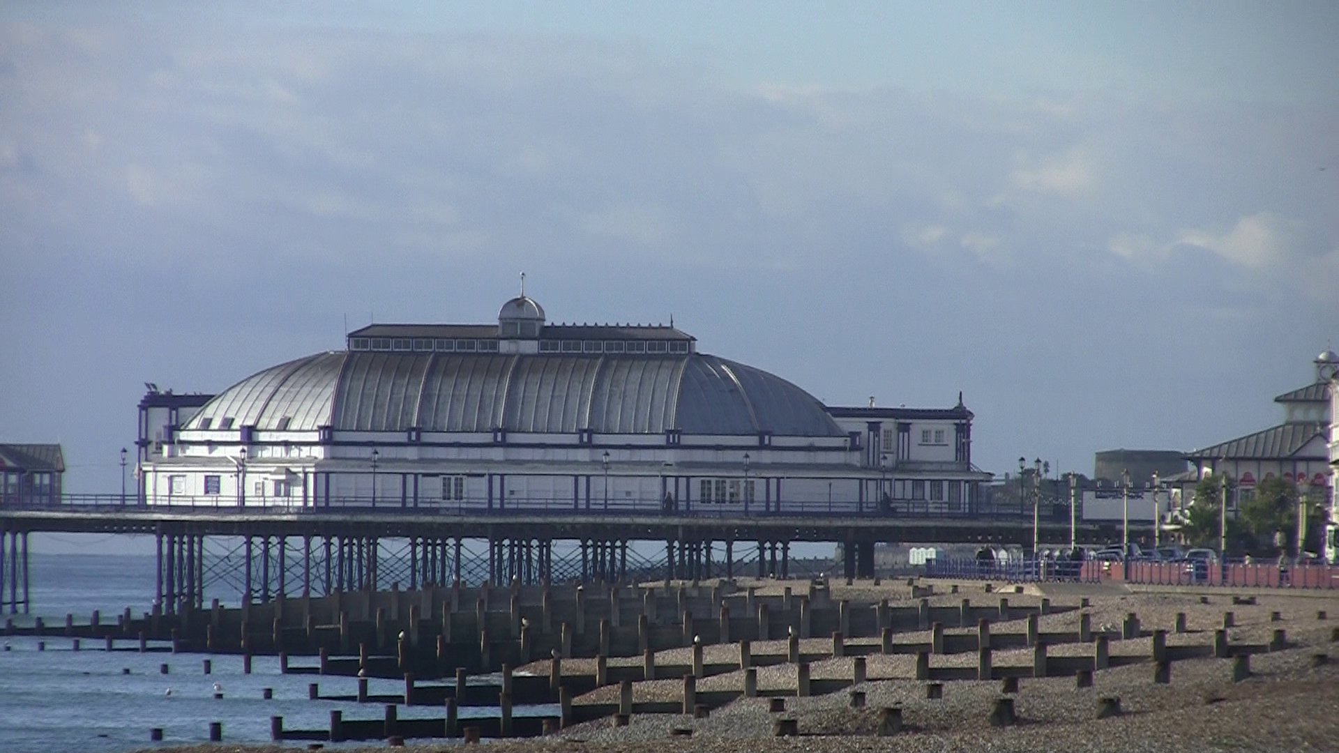

    This is the original:

    @intracube
    the result is great; the blacks are stronger and they gives a more contrasty look (although sometimes may affect the details in darker areas)
    Thanks. There isn't any difference between the two examples other than resizing & sharpening. No colour correction or contrast changes have been made.
    If you've got an LCD screen, and are looking at the 2 examples one above the other - the bottom image might look more washed out/pale. The quality of images on LCDs can vary with different viewing angles - on mine it's quite noticeable.
