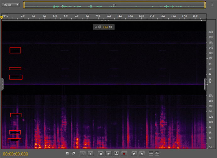

  2. I'm wondering if there's a way to be more selective?
    For cool edit you should be able to use spectral view to isolate the ringing , and either delete it or adjust the volume or use some other filter . I did this in soundbooth, but soundbooth & audition are essentially the same thing as cool edit (Adobe bought Cool Edit a few years ago)
    I attached an audio sample below and an screenshot of the amplified spectral view just to demonstrate the basic idea of how to select an area. You can see the pattern of the ringing in the low volume channel. This can become tedious very quickly because it's manual marquee selection.... but I don't know of a faster way that is as selective

  3. Member spiritgumm's Avatar
    Jan 2004
    looks promising, I'll give it a shot. You got rid of all the ringing, too (my attempt did not). Thanks.
  4. Originally Posted by spiritgumm View Post
    There's actually more ringing that the 3 bars , especially when there is speech - there is a 4th "bar" when there is talking, and I reduced the volume of that 4th bar (you can actually finesse it a lot better with frequency filters, to keep more speech if you had time to waste)
    open up the wav file I uploaded , normalize it (just to see the spectral view better) , and you will see 4 bars edited when there is speech going on , but only 3 where there isn't any speech - it's not shown clearly in the screenshot above

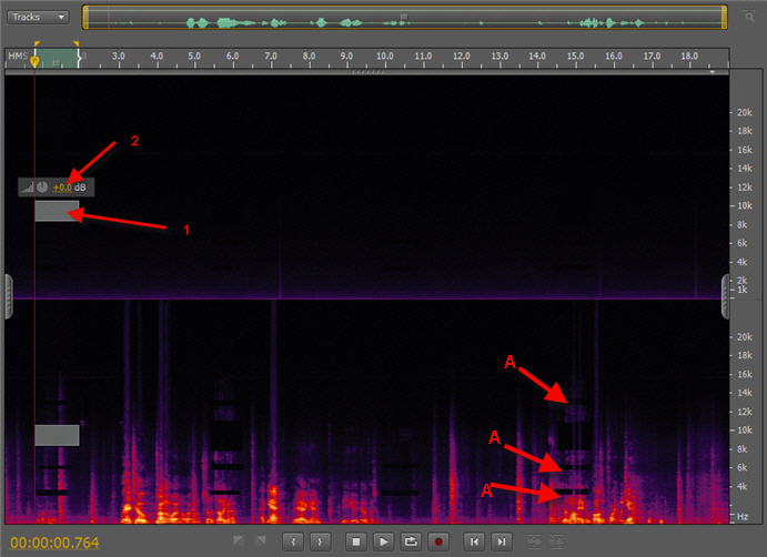

  8. ok i'm not sure if cool edit has it.... In Soundbooth its called "rectangular marquee select tool" and the icon looks like a box. Make sure you are viewing in the SPECTRAL VIEW (vertical axis is in frequency KHz , not dB like the regular waveform)
    There are 2 noise patterns, a consistent "phone ringing" in the background (those are the "3 bar" sections) , and also residual "squeeking voice" distortion when they speak, that is slightly different from the "phone ringing"
    In the screenshot:
    A) Those "3 bars" sometimes occur where there isn't any speech. In the ones labelled "A" they are overlapping with speech
    1) I draw a "box" around the area I want. It's set up so both channels are marked at the same time (the box is automatically drawn in the 2nd channel). The one labelled "1" is the marquee selection of the overlap where there is some distortion in the voices.
    2) I can change the dB of that "box" or apply any filter to that "box" when it's selected. Nothing else is affected when you marquee select, only the box highlighted
    In this screenshot, I've already deleted the other "3 bars" sections , if you compare to the earlier screenshot, there are "gaps" in the spectral graph
    But I suppose one could make a very long horizontal box with the marquee setting?
    The whole point is NOT to do that, other wise you affect all the other good sections. Since the ringing doesn't occur continuously, you only want to adjust it in those sections where it occurs (ie.. selectively). As you can see in the screenshot there are little "cut out boxes" at time frames where the problems occur only , instead of a long horizontal line that affects the whole duration
