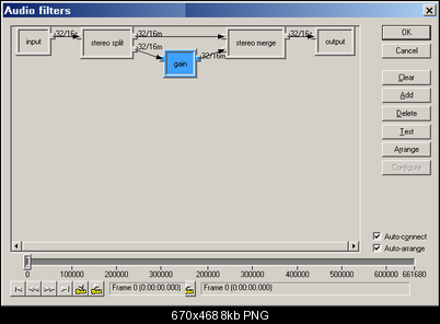

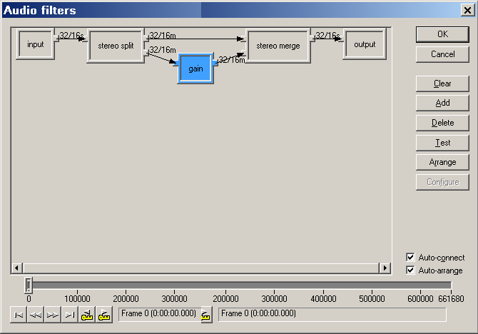

  6. If it's an AVI file you can use VirtualDub's built in audio filtering:
    That filter chain takes the audio from the source file, splits the stereo channels, amplifies the right channel, merges the two channels back into a stereo stream, then sends the merged channels to the output.
