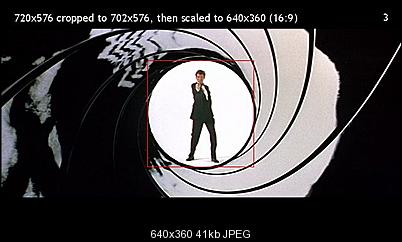

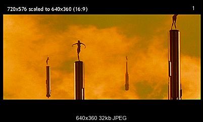

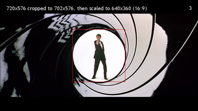

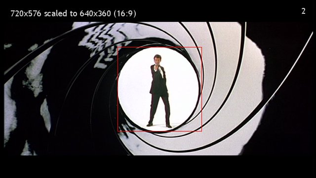

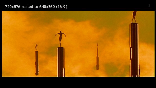

    Originally Posted by Jeff B View Post
    720x480 DVDs with blacks pixels on the left and right have looked like that on exact (or just) scan. That is true of both commercial DVDs and DVDs that I have encoded with HcEnc.
    These images are from Goldeneye (R2 DVD) 720x576 with 702x576 active area:
ID:	4046Click image for larger version
ID:	4047Click image for larger version
    The form has put them in the wrong order. Example 1 (bottom) shows the bars to the left/right. Example 2 (middle) with the red square overlayed shows the gun barrel is distorted. Example 3 has been cropped to 702 wide before being displayed at 16:9, and looks accurate. I don't think the difference in line standard matters for this test - it looks like some DVDs at least aren't going to be displayed correctly with your setup.
    I don't understand what you mean at all. Why are you scaling to 640x360? As I mentioned before, DVDs have always looked like this on every player I have ever owned, and on every TV I have ever owned that has an exact\just scan mode. Of course, I don't ever watch a DVD on exact scan. I always watch using 16:9 (wide) mode.

    Oct 2010
    England
    The 640x360 image represents a TV - 640x360 chosen because it's exactly 16:9, (for people viewing this thread on most computers, with square pixels) and because it's not too big for people viewing the forum with small computer screens.
    Apologies if I've not understood - I thought you and jagabo were saying that the full DVD image was displayed exactly 'as is' on your 16:9 sets (including small black bars to the left and right on some discs). My examples were to show that in the case of 'Goldeneye', the gun barrel is not a circle unless the image width is cropped to 704/702 before being displayed as a 16:9 image.
    Sorry, I didn't realize this. Though I'm not sure how your TV formats the signal '16:9 wide mode'.
    EDIT: Well, perhaps it is more accurate to say nominal analogue blanking rather than overscan. What I mean is that the eight pixels on either side, whether black pixels or not, are not meant to be seen. When I view DVDs on exact scan, there is always evidence of junk pixels on either side that are not meant to be seen.
    Ah, I understand. How you have you TV configured normally for DVDs (cropping the sides) is exactly what I thought should happen.
    But, I have other DVDs that are formatted differently to Goldeneye - and cropping the sides off them before displaying as 16:9 would make a circle end up too wide....

    What's your view on the Goldeneye images I posted?
    - The Goldeneye DVD doesn't have sequence_display_extension present
    - But if the entire image is displayed at 16:9, the gun barrel is distorted (see image 2)
