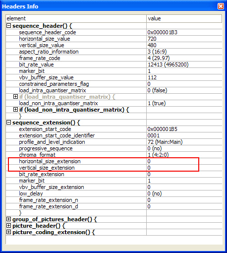

  3. I think elecard streameye might be able to

    The two options you've highlighted on your screenshot belong to sequence_extension. We're talking about sequence_display_extension and the associated display_horizontal_size, display_vertical_size.
    Elecard Streameye might still display the relevant data (if the disc has it). It's possible the disc you tried didn't have it.

  24. Originally Posted by intracube View Post
    Yes you're correct
