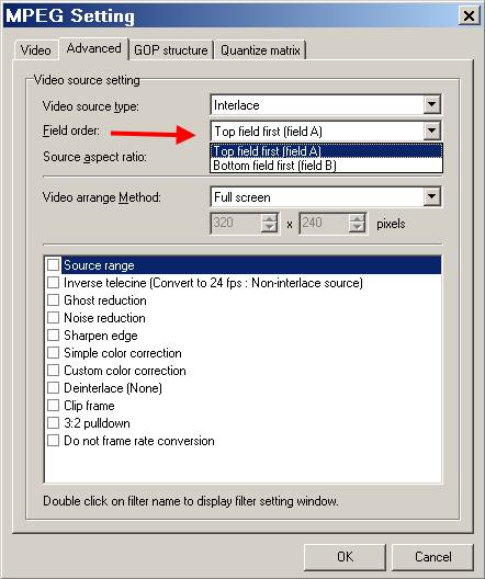

    That sounds like the wrong field order. Look for TFF or BFF settings, change from one to the other. Some software calles it Even/Odd, or A/B field order.

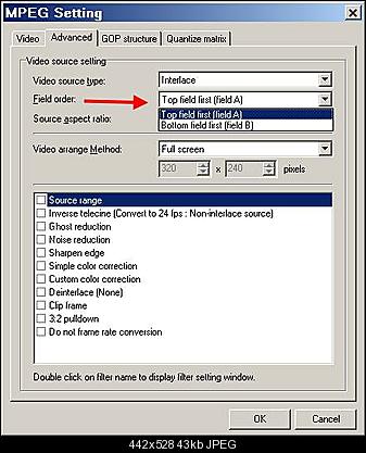

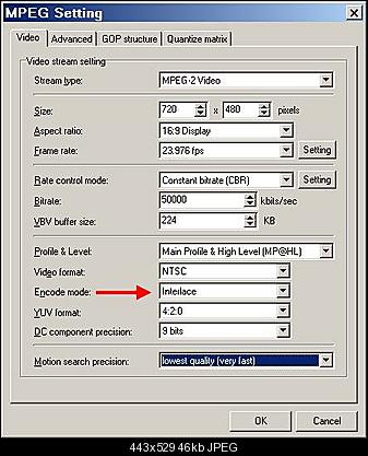

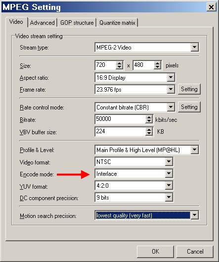

  12. We're talking about all MPEG 2 encoding software. I don't use DVD Flick so I can't tell you where the setting is or exactly what it's called. In TMPGEnc Plus it's here:
    and here:
    The first one tells the encoder what the field order of the source is. The second one tells the encoder to encode the video in interlaced mode (with the same field order as the source).

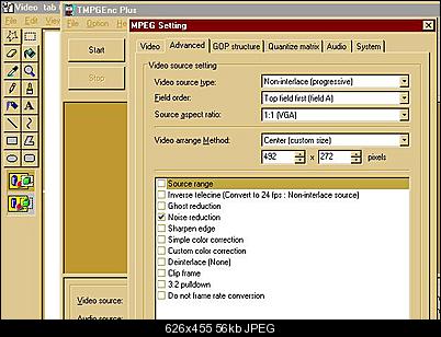

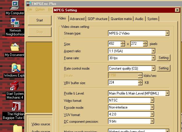

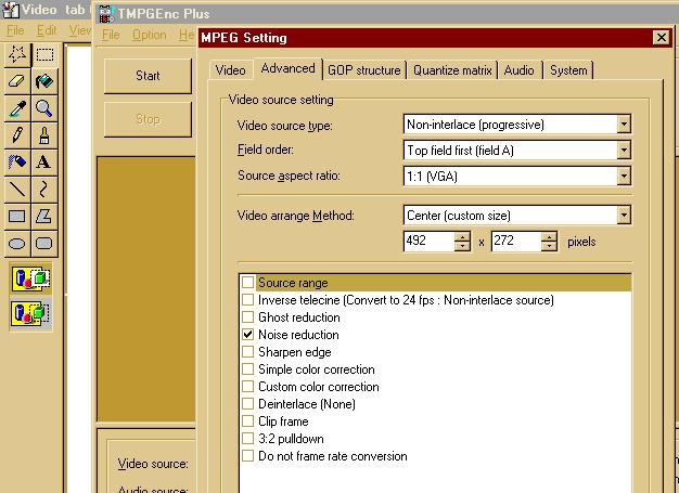

    Right. I've seeN that. Okay, here's what I have in TEMPGenc as of the last settings I had - I know they're wrong, but hopefully you can recommend the necessary changes: Hmm. Having trouble making the image bigger....
Name:	Video advanced tab tmpgnc.jpg
    [Attachment 4024 - Click to enlarge]

  20. Originally Posted by buddycat View Post
    [Attachment 4025 - Click to enlarge]
    Video Arrange method is set to Center Custom Size with the same size as your source file. That will distort the picture. It should be set to Center Keep Aspect Ratio or Full Screen Keep Aspect Ratio (unless your source isn't square pixel).
    A 492x272 AVI file isn't likely to be interlaced. So Video Source Type: Non-Interlace (Progressive) is probably correct and the Field Order setting won't matter.
