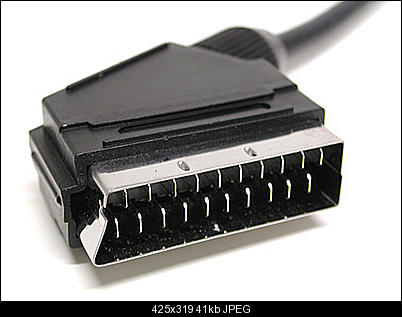

  4. There are three main analog video connections commonly used between a DVD player/recorder and a TV.

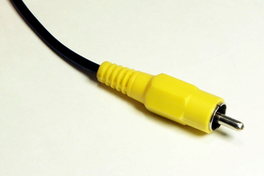

    composite:

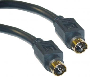

    s-video:

    SCART:

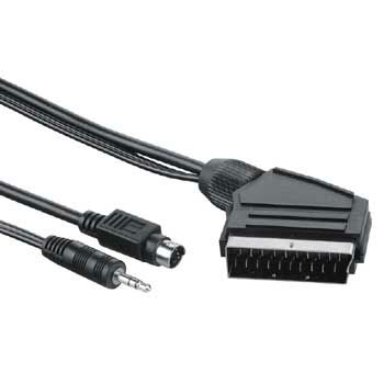

    The problem you describe isn't likely with a straight composite/composite, or s-video/s-video cable (a broken s-video cable might have it), or SCART/SCART cable. But it is very common when using a SCART/S-video cable like this one:
    because the adaptor isn't meant to be used in that way.
