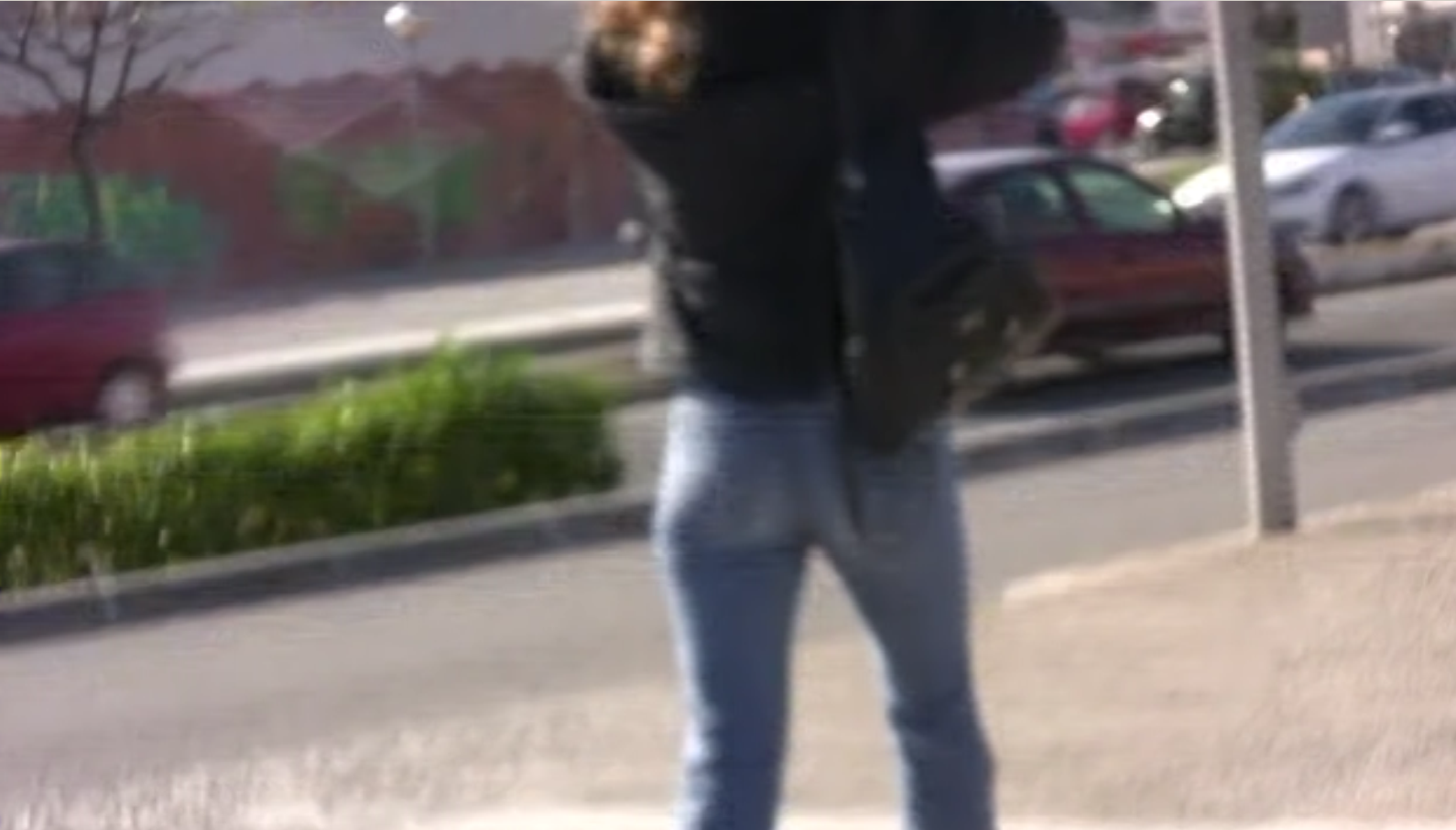

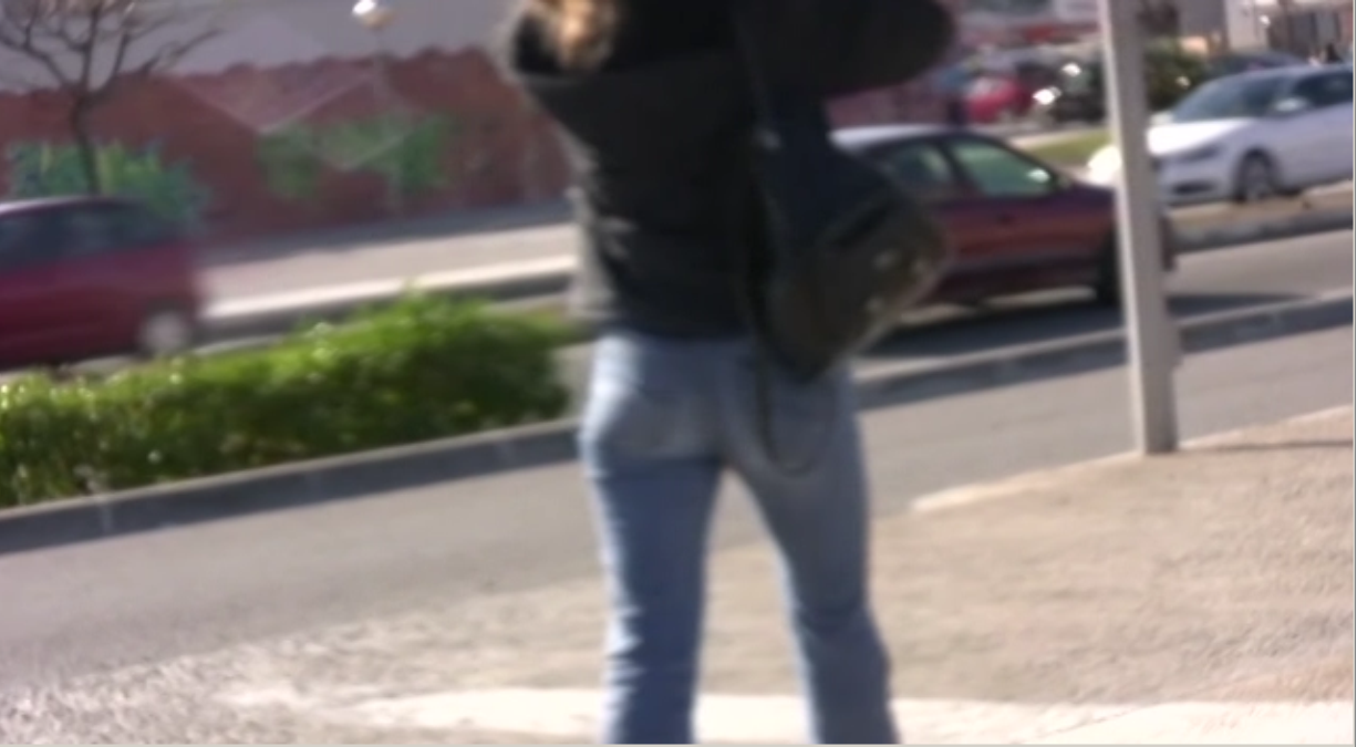

  24. Member
    Oct 2010
    France
    Well check that two screen shots (made withe the avs preview of megui). There are still jerky frame. I don't know how to handle them.

  25. You will never get perfect results with this type of conversion. Especially at the very end or very beginning of a clip.

  27. Aside from the repeated frames at the start I didn't see much jerkiness in the sample clip after that script. The jerky camera work and resulting motion blur make it hard to say for sure. Are you talking about the longer source? Maybe you should post a sample from one of the sections that's jerky after conversion.
