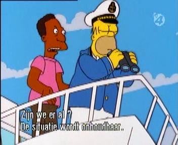

  1. Hi, I tried to make a DIVX of a home recorded DVD (DVD Recorder) from TV footage. I get picture with distorted quality, i.e. edgy lines and bad characters. I tried all de-interlacing settings, but the problem remains. I use Magic DVD Ripper with divx codec to encode to DIVX.
    Strangely, other DVD's (also homemade recorded TV footage) convert to Divx without these problems... I don't get it.
    See images below: badly readable subtitles and texts, edgy lines while the original (not on image) is absolutely flawless...
  2. Looks like a simple "discard field and resize" deinterlace. The best deinterlacers are in AviSynth: Yadif, TGMC, etc. Yadif is also available in VirtualDub.

  3. I tried the de-interlacing options in both the FFD and DIVX codec in Magic DVD Ripper, like Yadif etc... The result is the pictures above. I don't see how I can de-interlace the VOB files on my DVD?
  4. Moreover, Gspot suggests that the videosource (DVD) is progressive??
  5. If your source is progressive you shouldn't deinterlace. If this is not a professionally made DVD it's possible someone encoded an interlaced video as if it was progressive. Use a program like mpg2cut2 to extract a short segment with some motion and post it.

  7. That's definitely progressive. Here's a quick conversion to Xvid, Target Quantizer 3, with VirtualDubMod. No deinterlacing, no filtering at all.

    For some reason it decided to deinterlace the video, even though it's progressive.

  13. Here's the same frame as you posted above with a discard field and resize in VirtualDub:
    It looks just like your sample.
