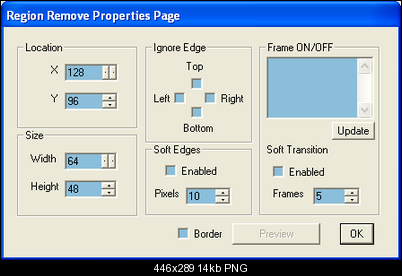

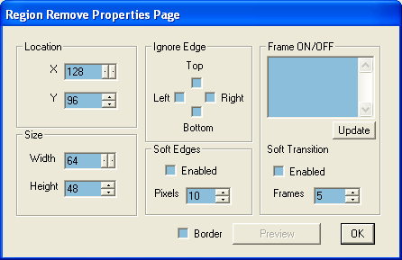

    There is a good plugin for Vdub called RegionRemove. It's fine, but just for short movies. Using it, I can set the list of frames and the plugin act only in that list. The problem is that the limit of the list. I tryed to put in the listbox all the frames I need to cover, but it accepted less than 100 lines...
    How to solve it?

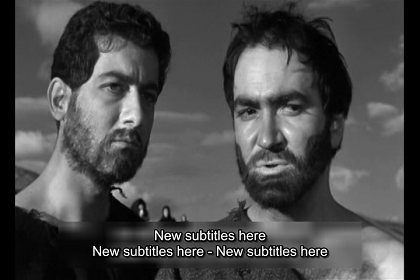

    Samples from the movie Electra, greek filme, 1962.
    original

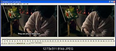

    As you see, RegionRemove had made a better job than my crop-resize script. Is there another way to write the script to get better results? Also to treat the borders. Borders at my script are too hard and visible...

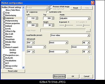

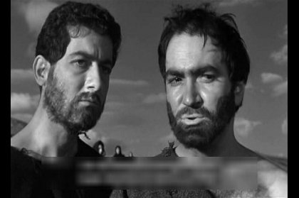

    I tried the logo filter in FFDshow (ffvdub.vdf) .Click image for larger version

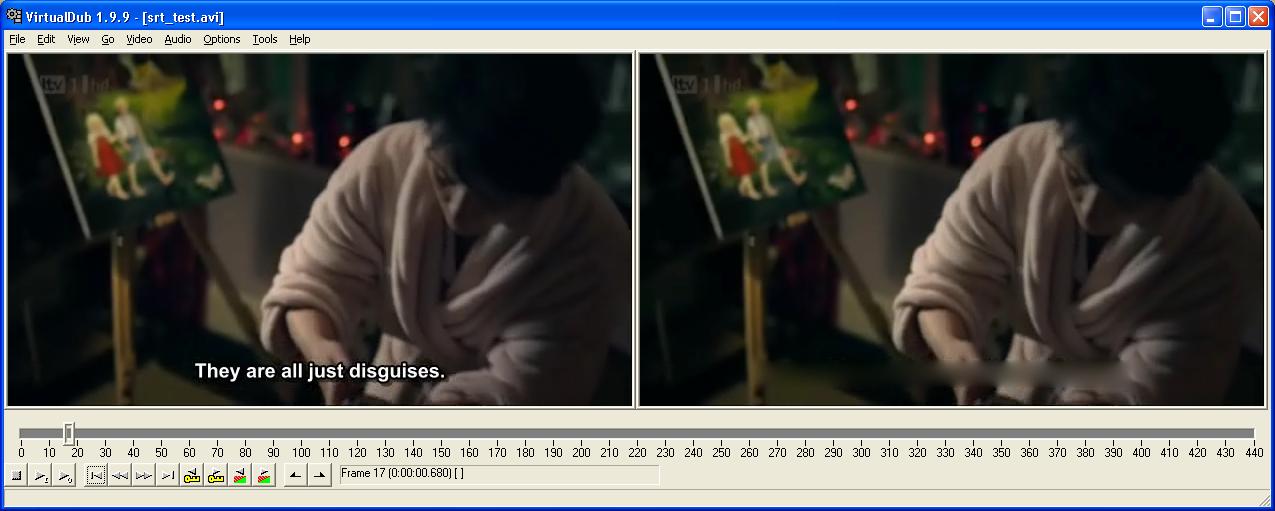

    The MSU subtitle remover has on and off, based on a first pass "detection" phase, in which it keeps
    track of the frames involved. I had no luck with it - have you tried it ?

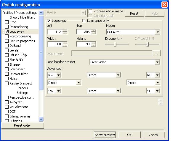

    Here's the settings I used in FFVdub :

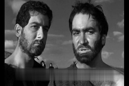

    I've already knew about MSU SubtitleRemover. Some time ago I run tests with it and I couldn't reach good results and I gave up.
    Now, using a black and white movie, maybe it is easier to the plugin detect the subtitles, and because you recall it for me, I got the results I'm posting below. See by yourself and tell me something:
    http://www.4shared.com/video/u-ILAGVa/msu2_.html
    http://www.4shared.com/video/nVLXgHIl/msu3_.html
    msu2 -> subs removed
    msu3 -> original subs
    I could notice that the plugin has some kind of problem when you change the parameters many times. It cannot detect subtitles anymore. I have to open again the video or even quit Vdub and try once more.
    The ffvdub you post, I haven't knew it, but the logoaway it uses is the same of logoaway.vdf standalone plugin I use. And the results are the same.
    Man, thank you for guiding me back to the right tool: MSU SubtitleRemover
