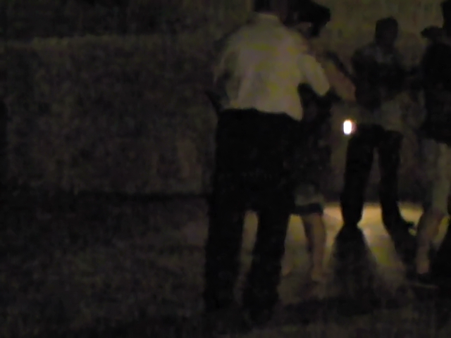

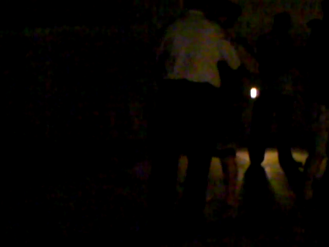

    In the meantime heres two screenshots taken at the exact same moment, the first one playing the MP4 file directly and the second one through avisynth using nothing more than a single line FFVideoSource to load the video (Yes, I know the video is dark already (hence why I want to prevent it from being DARKER) and of low quality, I have mixed videos from night and day shots, the day shots don't seem to become as dark as the night ones when put through AVIsynth):
    http://img257.imageshack.us/img257/9507/sany0144mp4snapshot0005.jpg
    http://img513.imageshack.us/img513/4236/test5avssnapshot0005201.jpg

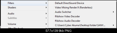

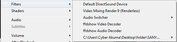

    Also, I noticed that Media Player Classic claims it is loading different decoders and colorspaces for each as well, I remember you mentioned this before and I assume its the problem, but I have no idea how to fix it, this is what MPC loads for the MP4 directly and through AVIsynth:
  2. It might be a levels issue, decoding at different ranges , but it's likely the way you took the screenshot (when you play the file directly it's going through a different chain of filters, renders) . vrm9 (renderless) is required to take screenshots through mpc, so it gives you a washout out look (normally looks bad, but might be beneficial in dark videos, artificially brightening it up) . If you change renderer to overlay mixer , then the graphics card overlay settings come into effect . Change the various renderers and see how the video's appearance "changes" . Note the underlying video hasn't changed at all, just the apperance of it. Prove this for yourself.
    This is easy to alter in the script , post the sample and I'll suggest a solution (I believe the underlying video is dark, but the renderer is artificially brightening it up. The dvd will be dark unless you change the levels in the script) . Another way of saying this is your playback issues are from how you have it setup in MPC
    You can cut a sample with yamb or avidemux , and upload it here directly if <30MB or a free hosting site (e.g. mediafire.com, sendspace.com)
    You might consider cleaning up the video before encoding to mpeg2 for dvd as well

  6. You're going to have to resize to 720x480 to make it dvd legal, also 59.94 fps isn't legal , so you can interlace it to keep the smoothess
    For the dark issue you can use a levels filter, it will expose more noise, so you can use a denoising filter and get rid of that chroma noise as well
    e.g. for 1 video, adjust the filters as you see fit

  18. You have to adjust/tweak the filter settings for each scene. I would fix each of the clips then add the transitions last
    Noise is always introduced when you brighten videos (increase levels), and denoising is always damaging. Either live with it dark, or brighten it up and introduce some noise. You're going to have to make some tradeoffs. You should have shot with more light, or used a better camera

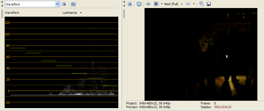

    The problem is a lot of the data (90%) is Y' <16 (illegal for video, the "superdark" region) . Legal video is 16-235. If you leave it as is, all that stuff in the dark will not be seen on a regular DVD/TV setup. It will look the 1st screenshot in post #40. When you adjust the levels, you will bring out the noise in the dark areas.
    This isn't avisynth's or ffmpeg's fault. If you load the clip in premiere or vegas it looks almost completely black (like screenshot #1 in post 40). The problem is most of your data is Y' <16 .
    If you loaded the files directly without any filters and made a dvd, you will notice the dvd will be very dark on a regular TV. Your preview in the media player was using VRM9 renderless (which brightens & washes out the video - a dvd player won't be using this renderer - and all that data <16 will not be visible. That's the whole point of bringing the levels up). Test it and see for yourself
    You can scale it to legal "TV" levels (16-235) by using levels or smoothlevels. This will be more "automatic" although you might want to make manual adjustments per scene, but the brighter you make it , the more noise will be revealed, and the stronger you will have to denoise (or maybe you can live with the noise)

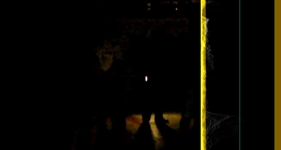

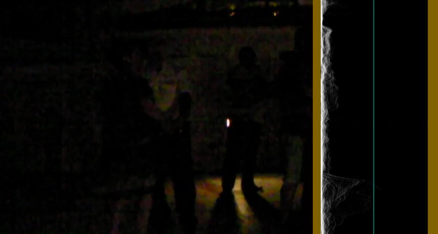

    I appended some screenshots to illustrate what is going on:
    1 - this is approximately what it will look like on a dvd. Notice most of the data is Y' <16. The histogram shows 16-235 in black, and the brown bars are "illegal" 0-16 and 235-255. The histogram is rotated 90 degrees to the right
    2 - after smoothlevels(preset="pc2tv"). Notice there the data is scaled to "legal" range now, but more noise is revealed in the dark regions
    3 - vegas - notice it looks just as dark - most of the data is illegal and will not be seen on a dvd player. (i.e it will look black). The waveform monitor uses 0-100 IRE (below 0 will not be seen, and notice most of the data resides below zero)
