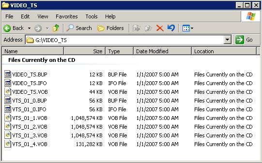

    My initial VHS to DVD rip resulted in this:
    I was not able to figure out how to use avidemux to work with these files. The DVD-R plays but I get errors when trying to open it (or any of the files) in avidemux. What you see in that pic is the result of me recording 5 15 min workouts onto one single DVD-R. Now the goal is to end up with 1 single DVD-R with 5 menu selections on the main menu screen (1 for each workout). The above pictured DVD is all one single file.
