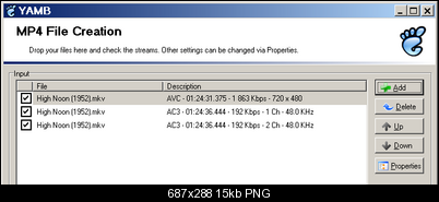

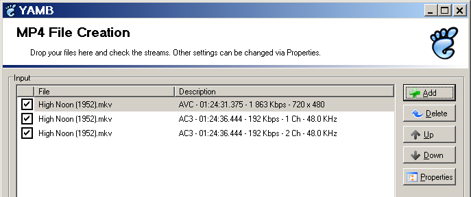

  15. Originally Posted by SoccerLover View Post
    Yamb doesn't support .mkv extension.
    Works for me:
    Maybe you need an update? Or maybe Haali mkv splitter?
  16. Originally Posted by jagabo View Post
    Works for me:
    [Attachment 3980 - Click to enlarge]
    I have the newest version. I doesn't support .mkv. It looks like your one is a very old version by watching the screenshot you provided.

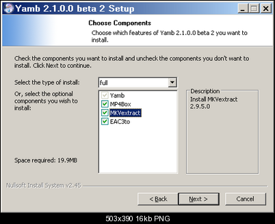

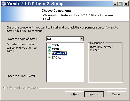

  17. I'm using the 2009-06-29 version (2.1.0.0 beta 2) which is the latest version, as far as I know.
    http://yamb.unite-video.com/index.html
    I suspect you didn't elect to include MkvExtract when you installed Yamb.

  18. Originally Posted by jagabo View Post
    [Attachment 4027 - Click to enlarge]
    Yeah, you had right, I didn't install the MKVextract, but now, when I add my files in there, it just gets an error and finishes...
  19. What does the error say? post the log file
