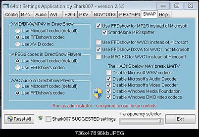

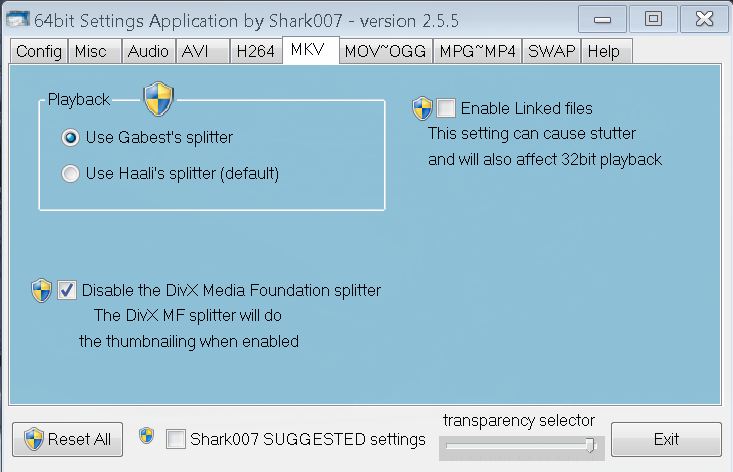

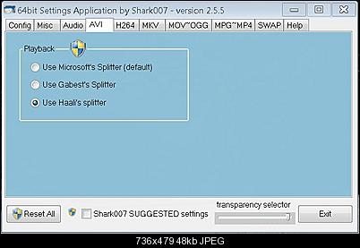

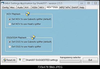

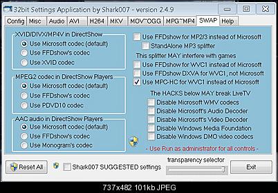

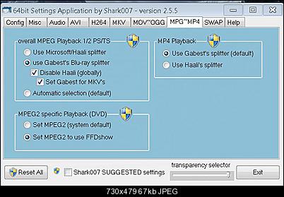

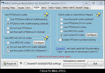

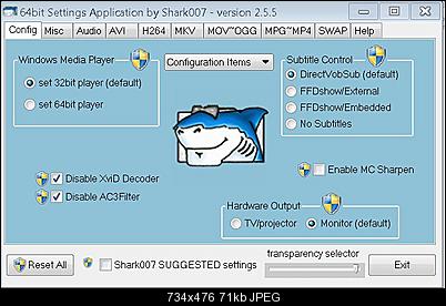

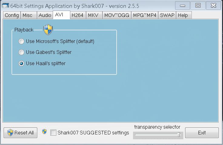

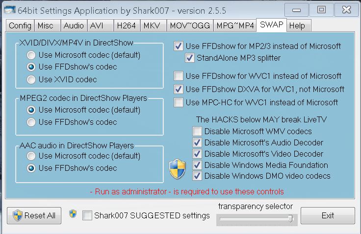

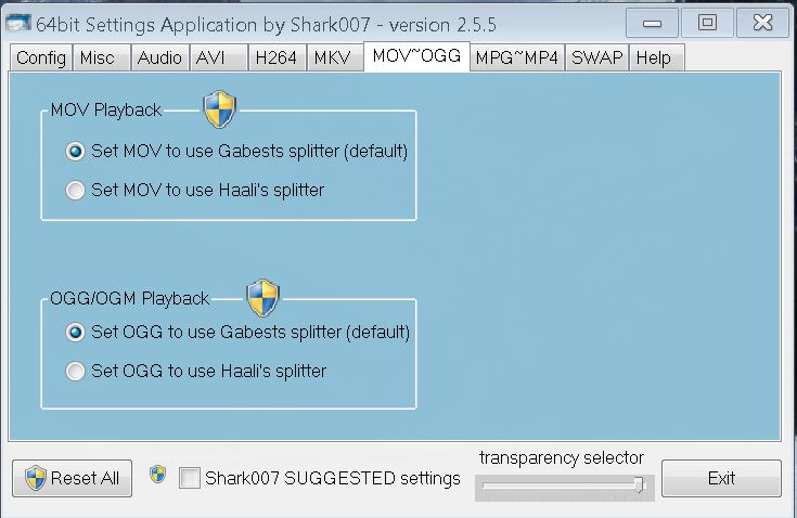

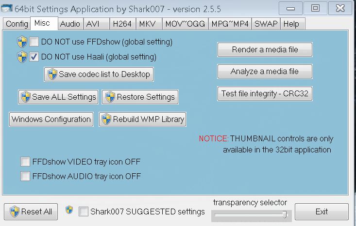

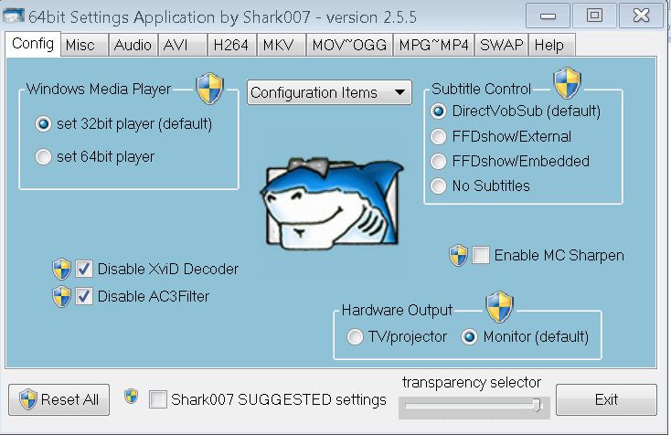

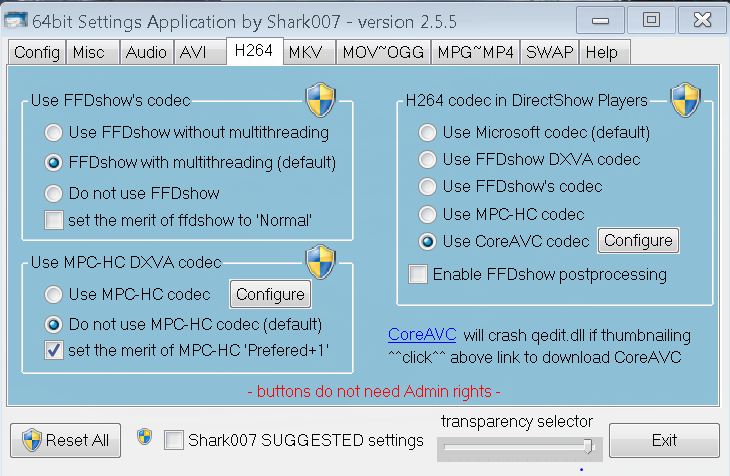

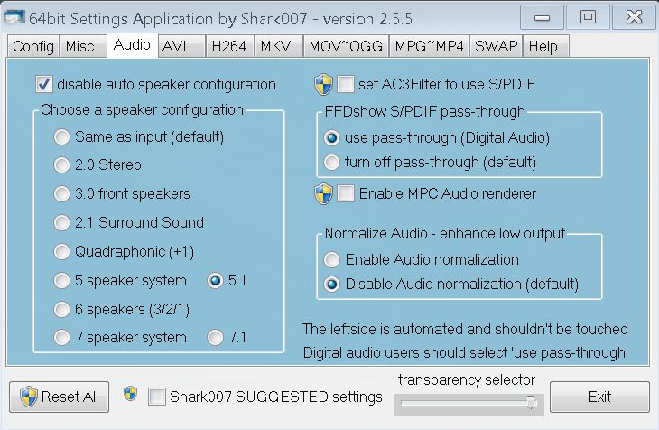

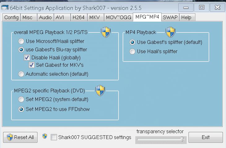

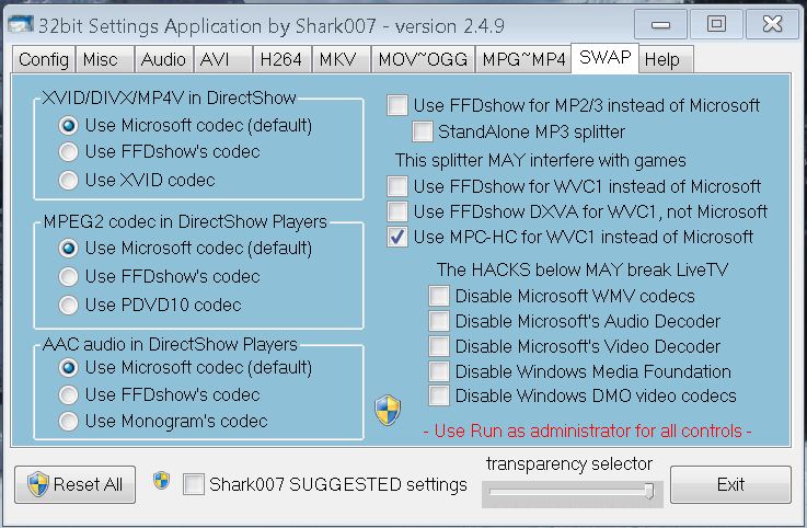

    Hi strontium_99 , I have the same Acer I use Shark 007 codec MPC-HC and Core 2.0 works a treat even with 1080p. make sure you take all of the bloat ware off the PC
    CHEERS GARRY
  5. Hi Garry, yeah I know what you mean about the bloatware, that was the first thing I did when I first got the PC
    I've downloaded the Shark 007 codec and installed it. Can I just ask how you've got your sysem setup please? Did you have to installed ffdshow first? And what settings are you using in Shark and MPC?
    Thanks for you help.
ID:	3986Click image for larger version
ID:	3987Click image for larger version
ID:	3990Click image for larger version
ID:	3982Click image for larger version
ID:	3985Click image for larger version
ID:	3984Click image for larger version
ID:	3988Click image for larger version
ID:	3983Click image for larger version
ID:	3981Click image for larger version
ID:	3989Sorry for the delay work is mad at the moment
    CHEERS GARRY
  7. Hi again Garry,
    Big thanks for the screen shots. Have been having a play with the codec settings, also installed CoreAVC 2.0 codec which I presumed you meant by Core 2.0. Picture quality is great now, no stutter or anything. The only odd this is if I play a DVD rip that I've taken it will play back in 5.1 Cool. If I play, say an, mp4 with AAC with 5.1, 6 or 7 channel audio it only seems to play back in stereo even after setting the audio settings to pass-through and 5.1. Have you run into a problem like this?
    Thanks again for all your help.
    Cheers,
    Andy.
