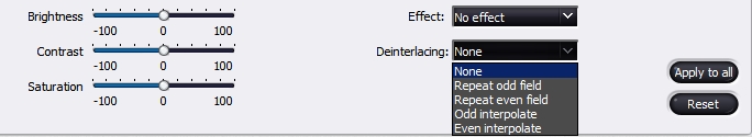

    Thank you guys for the explanation. Jagabo, that's a good one. Manono, how can I know the field order? Thanks.
    This is why I posted the OP. Under "Deinterlace" I was given choices that made me curious. Just to let you know, I already was done with YouTube posting. I'm very satisfied with the output except that I thought I could have done better if I selected one of these. This is Daniusoft Video converter(free)

  11. Member 2Bdecided's Avatar
    Nov 2007
    He's not asking about field order - just which one of those options to choose! You don't even need to know the field order for any of those options.
    The software is just asking you which field to keep, and which to throw away. It doesn't matter at all.
    It's also asking you what to do with the resulting gap - again, for YouTube, it doesn't really matter, but none of these options are good because this software isn't going a very sophisticated job of deinterlacing.
    For SD DV > YouTube, I'd deinterlace properly. YouTube isn't great quality, but the results of crappy deinterlacing (i.e. just throwing away one field) are still visibly poorer on YouTube than doing a better job. However, top-notch deinterlacing takes time, so unless you want to spend more time on it, just stick to throwing one field away.
