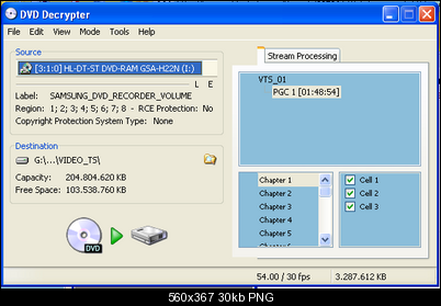

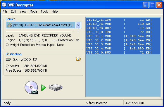

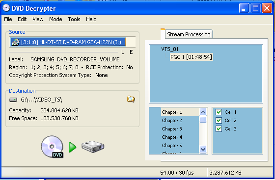

  6. Hi hech54
    Good to recall DVDDecrypter. But I couldn't find a dumb or a piece of menu at the file list. It has only one PGC. Below the screenshots in File F and IFO I modes:

  7. Member hech54's Avatar
    Jul 2001
    Yank in Europe
    My next trick is to run the ripped DVD (not demuxed though) through FixVTS. It was originally made to fix DVD Recorder disc errors.
