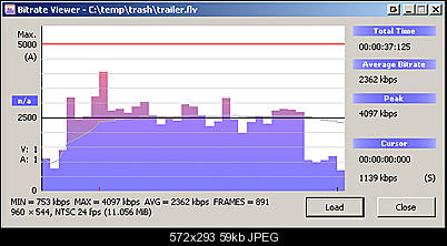

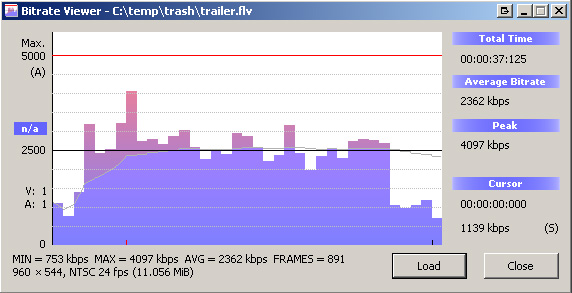

  3. Hi Jagabo,
    Thank you for you quick reply. I downloaded it and check the file. It seems it doesn't have a 1500kbps max bitrate.
    It exceed this limit to an average of 2362kbps, but can this explain the 35% of the filesize used for something else?

  4. Originally Posted by Abstract40 View Post
    1500 was entered. It wasn't achieved. The encoder overshot. It's not the max bitrate either
    Can I take the outcome of MediaInfo serious? Is this 35% really used for something else then audio and video or is this only what the header info says about the file?
    It only reports the header, it may or may not be accurate
    If you are paranoid, you can use flv extract to see how large the video and audio stream are. There will be a timecodes.txt file as well, but that should only take 1KB or so. The other few KB are overhead for the flv container
  5. You can't take MediaInfo's bitrate report as the actual average bitrate of the video. The header can say anything. Taking BitrateViewer's reported average of 2362 kbps:
    2362 kbps * 37 seconds ~= 87384 Kbits or 10924 KBytes, not the 6.65 MiB reported by MediaInfo. So there's your "missing" bits.
