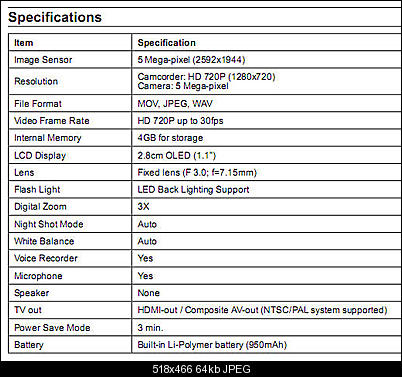

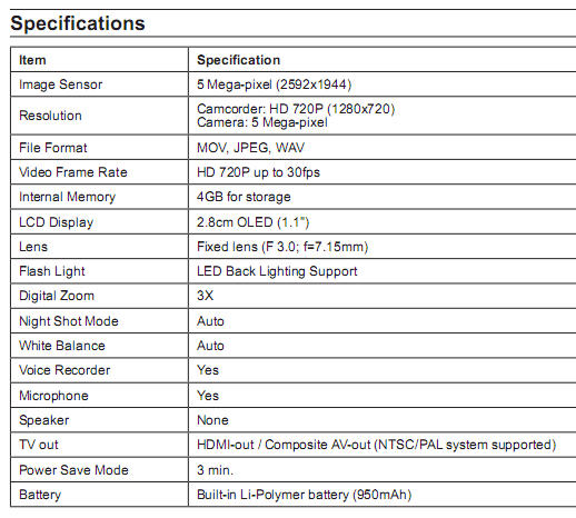

    Here's the specs on the cameras.
Name:	pencam specs.jpg

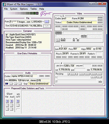

    And here's the specs on the source video.
Name:	source file properties.jpg
    Should I be choosing AVCHD or HDV?
    Or something else?

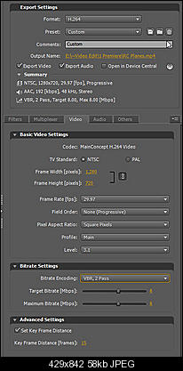

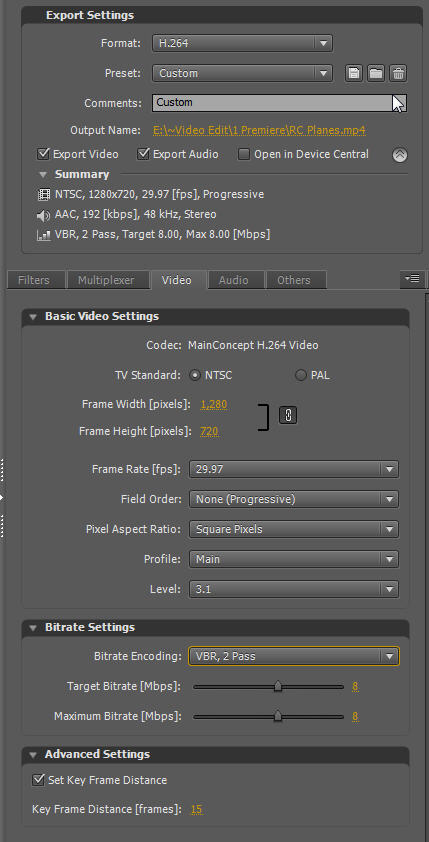

  2. Thought I would add a little more info, since this thread isn't generating much interest yet.
    Here's the AME export settings I have been using for youtube.
Name:	Premiere Settings.jpg
    Oct 2005
    666th portal
    your project should probably be avchd 720 30p, not hdv it's mpeg-2 not mpeg-4.
    if you aren't happy with the quality increase the bitrate target and max. if you choose both as the same number you might as well use cbr 1 pass and cut the render time in half.

    Explain again your source video format? GSpot says codec status undetermined.
    First thing I would do is decompress the camera file to 1280x720p 29.97. If you can't handle uncompressed (2 disk RAID needed) then explain more what type of editing is required. An RGB JPG or PNG frame sequence may be needed. Idea is to keep it in progressive frames on the timeline without temporal compression.
    Thanks for answering.
    As a test, I once chose an absurdly high bitrate.. about 40 I think.
    My quad processor with 8gb RAM was about brought to it's knees trying to play it.
    So, maybe I should ask what bitrate seems reasonable for good quality.
    Do extra passes increase quality?

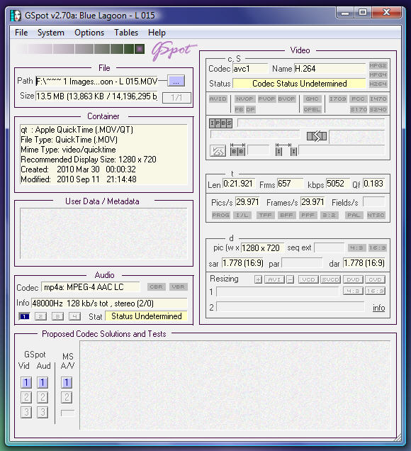

  6. Originally Posted by edDV View Post
    PS: forgot you wanted to do 3D, that means you need two progressive timelines (4-5 disk RAID for uncompressed).
    Yeah, I was also wondering why it says undetermined.
    Guess I will have to check on how to decompress the files.

    What is the camera? Try Mediainfo to id the codec.
    You are running a dual video timeline project. This doubles the CPU power needed for 1x playback or search/scrub. When you add filters you will need to render the workspace to get a preview.

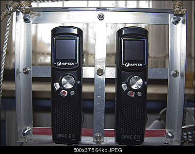

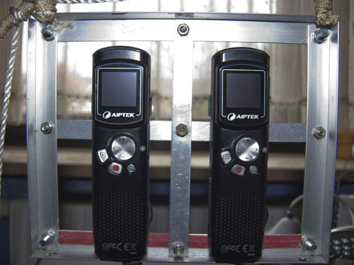

    Thanks so much for answering.
    I have two of these for my dual stream footage.
    PenCam Trio HD
Name:	camera rig - sm.jpg

    Original File:
    General
    Complete name : F:\~~~ 1 Images~~~\~V~\~~Cameras\2010-08-26 bowsprit - L\bowsprit - L 004.MOV
    Format : MPEG-4
    Format profile : QuickTime
    Codec ID : qt
    File size : 39.5 MiB
    Duration : 1mn 5s
    Overall bit rate : 5 073 Kbps
    Encoded date : UTC 2010-03-20 20:11:40
    Tagged date : UTC 2010-09-19 12:37:30
    Writing library : Apple QuickTime
    AMBA :
    Video
    Format : AVC
    Format profile : Main@L4.0
    Format settings, CABAC : Yes
    Format settings, ReFrames : 4 frames
    Format settings, GOP : M=3, N=15
    Codec ID : avc1
    Duration : 1mn 5s
    Bit rate mode : Variable
    Bit rate : 5 019 Kbps
    Maximum bit rate : 5 000 Kbps
    Width : 1 280 pixels
    Height : 720 pixels
    Display aspect ratio : 16:9
    Frame rate mode : Constant
    Frame rate : 29.970 fps
    Color space : YUV
    Chroma subsampling : 4:2:0
    Bit depth : 8 bits
    Scan type : Progressive
    Bits/(Pixel*Frame) : 0.182
    Stream size : 39.0 MiB (99%)
    Title : Ambarella AVC
    Language : English
    Tagged date : UTC 2010-03-20 20:11:40
