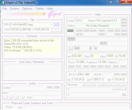

  4. here is a screen shot off Gspot

    The last time I saw something like this happen the file was written onto a bad sector on the Hard Drive. Have you been able to play it with another video player such as VLC? According to Gspot it is on drive D, can you drag it onto drive C?

    Under container it says that you have an 2.89 gb file, but 2.88gb of it is rubbish. I am going to lean twords corrupted file. Unless other suggestions abound you might try replacing the header from a working mpg file you created using the same method. This gets tricky, but you'd have to open the file using a hex editor and try comparing the results to that of the one that is working.
  9. First, the file is an AVI file, not an MPG file. It must have been renamed with the wrong extension at some point. GSpot does have problems with large files sizes (the "unneeded bytes" problem) but I don't think it starts until you get over 4GB. The file contains uncompressed YUY2 video according to the fourcc. With a ~3 GB file size and 640x480 frames it should contain about 5000 frames (about 6 minutes at the indicated 15 fps). I would try opening it with VirtualDub and see if that shows more than 2 seconds. It might be possible to patch the header to adjust the frame count. That doesn't necessarily mean the rest of the file will contain valid, uncorrupted data.
