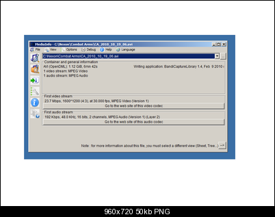

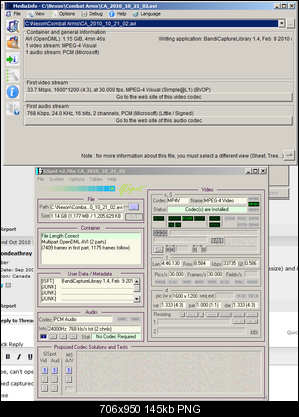

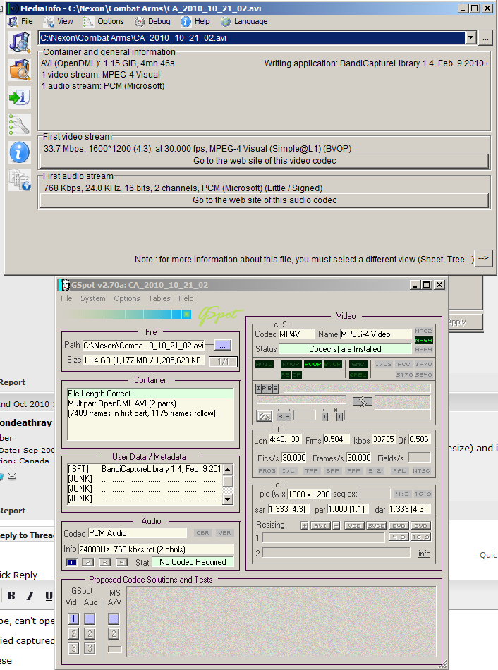

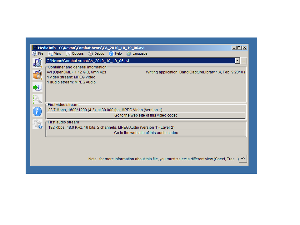

    try identifying the type of video it is with mediainfo and/or gspot. 1600x1200 is a non standard size. mpeg could be mpeg1 mpeg2 mpeg4? do you know how the source material was created?

  4. Click image for larger version

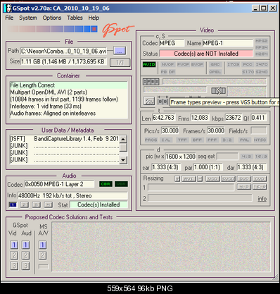

    there you go.

    gspot seems to have identified your problem. upper right - "codec not installed". looks like you need an mpeg-1 video codec installed on your computer.
    strange one to not have, as i thought all windows came with it installed.
    you might try changing the extension of the video file to .mpg instead of .avi and see if that helps vegas read it.

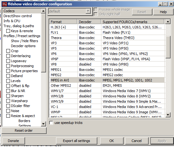

    if you install ffdshow, you can try enabling "mpeg in avi" in the ffdshow vfw configuration (yellow icon) . Set it to libavcodec instead of disabled
    if that doesn't work, you can try re-wrapping it with ffmpeg into mpeg2 program stream (.mpg)

    the mpeg-1 codec is listed in ffdshow if you want to try that. you might have to enable it in the configuration/codecs tab, and also the mpeg-1 in avi setting.

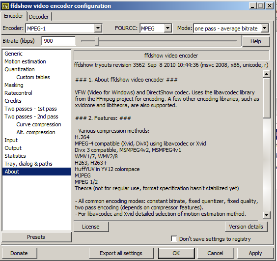

    yes @ gameplay
    I can't select the format I'm Using their own integrated software
    like this?

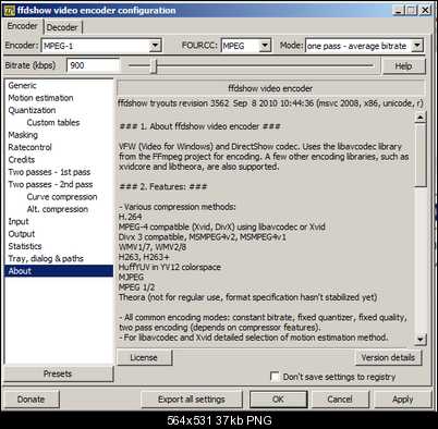

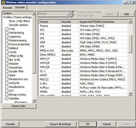

  13. no, the vfw configuration (yellow icon, not red icon). See the earlier post
  14. Click image for larger version
    yellow?
    edit: found it
    directions ?
  15. yes, yellow icon
    you might have a bad version , try another build
    it will be called ffdshow vfw interface
  16. update... It only worked the audio part....
    the visual part is not working yet

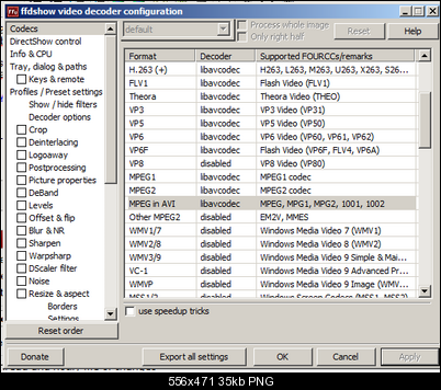

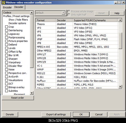

  17. that's the encoder , use the decoder tab

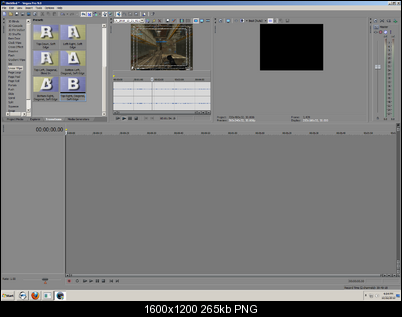

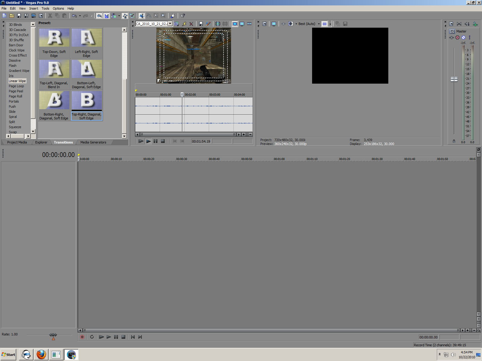

  26. Success, after installing ffdshow 64 bit sony worked...
    it displays like this, is it correct?
