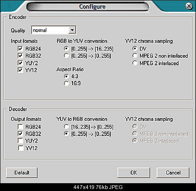

    So following that I went into Cedocida and changed the ouput from YUY2 (which I use when decoding for CCE) to RGB. Now the AVIs play in Virtualdub. But 2 other quick questions and I think I'll be all set:
    1) Do I set the Cedocida decoder output to RGB24 or RGB32 for Virtualdub? I don't know which one Virtualdub uses. Isn't RGB24 slower to process than RGB32?
    2) I think the Cedocida decoder should be set at 0..255>0.255 correct? And do I need to worry about the Encoder settings on the top if I'm just using Virtualdub for Direct Stream copy?
    So here's what Cedocida looks like now. Should anything here be changed?

  6. Originally Posted by sasuweh View Post
    I think RGB32, but I don't remember for sure. Maybe both.
    It doesn't matter what you have it set to for Direct Stream Copy cut/paste editing. The decompression and conversion is only used to show you the picture in VirtualDub. The video frames themselves pass from the input file to the output file without any changes, no decompression or compression. 16-235 -> 0-255 will look correct on the computer monitor.
  7. Just noticed I was still adding to my last post as you were answering. Okay, my screenshot above is what it looks like right now. Since I'm just doing a direct stream copy I should be all set then. Now I can actually play the video in virtualdub while I'm setting the trim marks. Any difference if I set encoder quality to normal or fast?
  8. Originally Posted by sasuweh View Post
    No, because you're not using the encoder when you have it set to direct stream copy and making cuts
