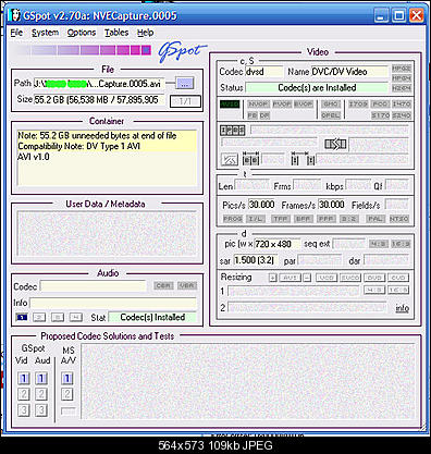

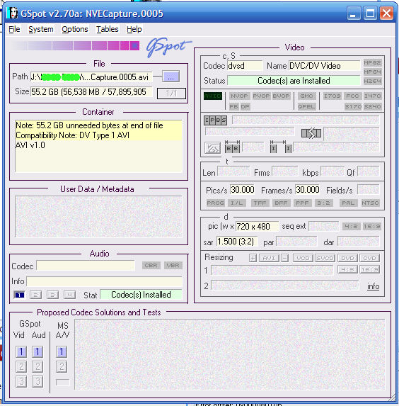

    I have also tried GSpot. Gspot says it has the codecs, and :
    Note: 55.2 GB unneeded bytes at end of file
    Compatibility Note: DV Type 1 AVI
    AVI v1.0
    Codec dvsd
    Name DVC/DV Video
    (Anything else is attached on image)

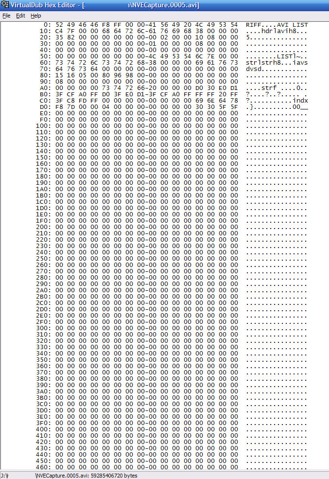

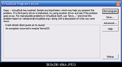

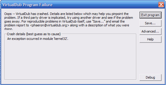

    I then opened Hex Editor in VD and from there, opened the File, i was able to save that text file, and use the menus, (e.g. File, Edit and Help), But when i go to scroll, i get an Error (Attached) Popping up.
    I have attached a screenshot of the Error, and of the HEX file..
    Is it Completely gone?
  7. Mod Neophyte redwudz's Avatar
    USA
    Unfortunately, it looks like it is gone. That's a lot of zeros where there should be numbers similar to the first line. (Data) Compare that to a known good video and you will see the difference.
