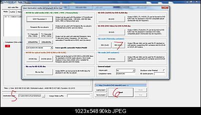

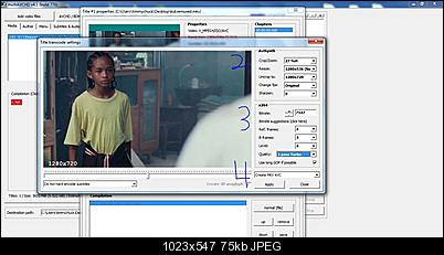

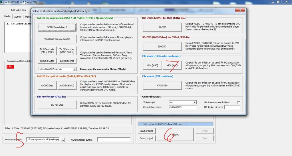

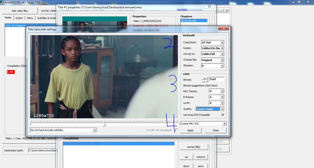

    You going to have to encode it. Try using multiAVCHD
    1. Load file and hit transcode button
    2. set crop/zoom
    3. set bitrate
    4. set file type MKV
    5. set destination
    6. hit start
    7. hit MKV file type (it start encoding

    Timmychuck, MultiAVCHD worked beautifully. The only problem was that it split the file, I just need to figure it out why. Any suggestions on bit rate setting?

    I had same problem one time.
    Goto the Author tab, on right side you see General .
    Look for, media (mts) split at (MiB) put in a high number in( I have 10000 on mine)
    What its doing is spitting at a certain point of file size.
    Do not put 0 on it ,you end up with about 3000 mkv files. This happen to me
