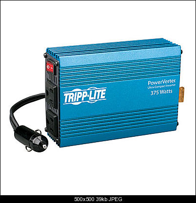

    ~27 watts power draw, add in the inverter loss and with a regular car battery more like several hours. I've ran my laptop from my inverter and the motorcycle sized battery in my car jumper box lasts about three or four hours. I did this for nine days when a major stormed knocked out most of our high voltage transmission lines. I took the jumper box to work each day and charged it with our standby generator.
    This is the inverter I have at present:
