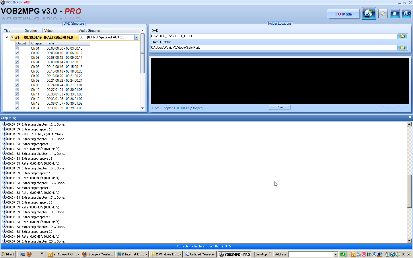

    Hi -I have just paid for the full version of this product and it seems pretty straight forward but it has truncated my DVD? I have a vista system and I am try to rip a what is essentially a simple home video. It is made up of 27 chapters (which are in reallity just 27 presses of the record button). If I play the DVD using Windows Media Player it can 'see' 27 chapters and I can navigate between them and play them all. In VOB2 it lists 27 chapters but chapters 14 to 27 are all listsed with the same start and end time 00:39:01:09? The log says all of these chapters have been extracted successfully but that the rate was 0 Mb/s. The resulting mpg file as displayed in Windows Movie Maker is 39 minutes long! Maybe I've missed a setting somewhere or something, can anyone advise?

    Anyway I coudln't find the log file so I ran it again and took a screen shot of the log so hopefully you can see the problem ... evry thing up to chap 13 seems ok and then from there on it is all zero but as I say Windows Media Player can see these chapters and play them?

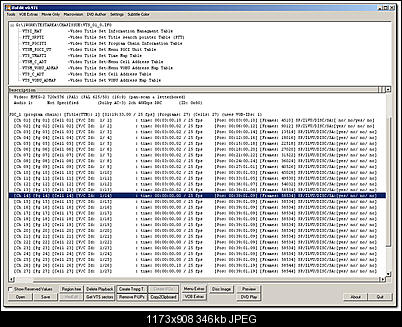

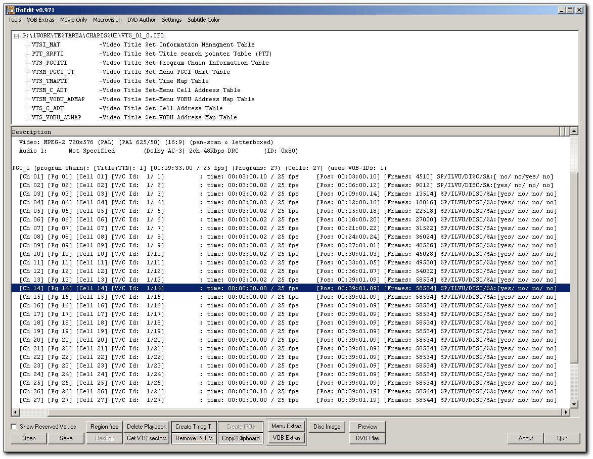

  13. Member ChrissyBoy's Avatar
    Feb 2003
    Yorkshire!
    Well. The issue is that the IFO files are incorrect. They are reporting the wrong end point of the chapters beyond 14. Here is what IFOEdit makes of it:
    Which is the same as how VOB2MPG has parsed them. So is this a recurring problem or just a one off? If it is a recurring problem i will see if there is any way we can resolve this. If it is a one off then i suspect there is not much that can be done.
    FYI: The reason WMP etc can handle the incorrect IFOs is because the start points of the chapters are ok. Therefore you can navigate to them and play then. What V2M and IFOEdit are doing is making use of the end point and it is this which is wrong here.
