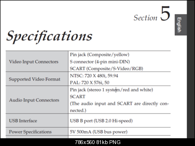

    I looked at the European version of the ADVC Mini. It captures interlace composite, S-Video or SCART RGB PAL to 720x576i in a Quicktime MOV wrapper over USB2. The resulting capture to iMovie is similar to 576i DV for workflow.
    From the manual ...
    http://www.grassvalley.com/docs/Manuals/professional/advcmini/ADVCmini_InstallationGuide-EN.pdf

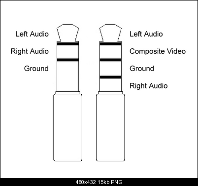

    As you've seen, pins on the SCART connector are shared by the different output modes (RGB, s-video, composite). The cable/adapter doesn't convert anything, just routes the SCART pins to the different connectors at the other end. That means you must configure the source device to output the correct signal, RGB, s-video, or composite -- in your case, s-video. A grayscale picture indicates the device can't output s-video or was configured to output composite video.
    Regarding the single channel audio, it sounds to me like you were using a mono Y adapter. You probably need a a left/right/composite to pin-plug A/V adapter, or stereo RCA to stereo pin-plug adapter, not a Y adapter.
    A/V adapter, note the four contacts at the 3.5mm end (very common on camcorders):
    http://www.amazon.com/6FT-Camcorder-Video-Cable-Sony/dp/B000I1D0BW/
    Stereo audio adapter, not the three contacts at the 3.5mm end:
    http://www.amazon.com/Cables-Unlimited-Stereo-3-5mm-AUD-1200-25/dp/B0016LTZFI/

  28. Originally Posted by MervynG View Post
    It may be that changing the adjacent SCART socket output which I can adjust via an on-screen menu, it also changes the S-video but I just don't know and it seems unlikely.
    I know a lot of devices with dual SCART outputs support only minimal formats on the second output.
    However even with an S-video to S-video cable between the two devices the image on the camcorder's LCD was monochrome?
    You aren't using mixed PAL and NTSC equipment are you? Most PAL equipment (VHS decks, for example) will output a hybrid PAL60 signal when displaying NTSC material. This often causes a B/W image on recording devices.

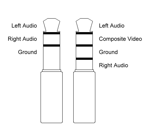

    As for the audio I have taken the cable back (together with the 'Y' adapter that was supplied with it) but it was definitely a three contact plug at the 'bottom' output end of the 'Y' adaptor which I thought was stereo?
    I don't know how standardized the 4 conductor pinouts are but from what I've seen, if the camcorder was expecting a 4 conductor plug and you used a 3 conductor stereo RCA to 3.5 mm plug adapter, I would expect you to get left audio only:
  29. Dear Jagabo
    I think you have probably explained the audio issue thank you - the camcorder perhaps needed a 4 contact 3.5mm jack! Certainly the supplied STV-250N stereo video cable has four contacts.
    As for the video, I just don't know. The Sky+ box is a UK one (PAL) and the Canon camcorder was for the UK market too. There are 2 SCARTS and the spec says one is composite in/out or RGB in and the other composite out or RGB out. The adjacent S-video socket spec just says 4-way mini-DIN. I can switch one of the SCART outputs between PAL and RGB (I assume that means composite or RGB) but cannot access anything to do with the S-video socket so I assumed it was pushing out S-video all the time. Maybe I should have switched the SCART output to see if (bizarrely) that affected the S-video socket output.
