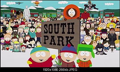

  2. It doesn't matter what resolution they were produced in. What matters is what resolution they're broadcast to you at. Many new cartoons are produced at HD resolutions (South Park for example). If you're receiving a standard definition satellite or cable feed you're getting much less. And of course, many older cartoons were produced on film so the originals are high resolution too.
