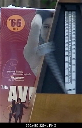

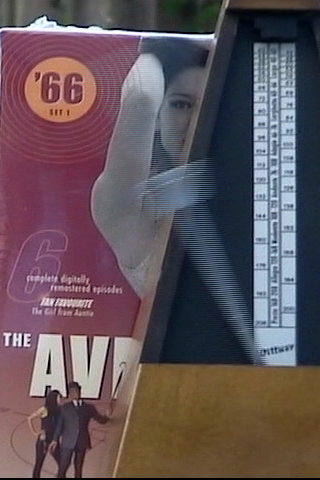

  11. No need to deinterlace. If the conversion to DVD goes correctly the DVD player or TV will display the interlaced video properly.
    What you need to understand is that each frame of interlaced video contains two half pictures called fields. One field is in all the even numbered scanlines, the other in all the odd numbered scanlines. These are intended to be viewed one field at a time, in sequence. If the two fields are displayed at the same time (as a progressive frame) you will see comb artifacts anywhere there is motion. If the interlace frame is mishandled, resized vertically for example, the two fields will no longer be separable. The result will not display correctly.
    A crop from an interlaced frame (note the comb artifacts on the pendulum):

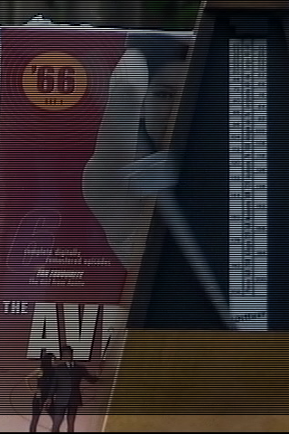

    Each field should be displayed separately (note the different location of the pendulum):
ID:	3862 Click image for larger version

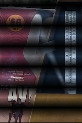

    Yes, because the video was resized without taking into account that it was interlaced. The two fields are no longer separate. Here's the interlaced image resized improperly:
    The thickness of the lines will depend on exactly what resizing algorithm was used and how much the frame was resized.

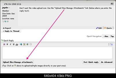

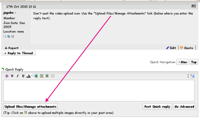

  26. Don't use the video upload icon. Use the "Upload files/Manage Attachments" link (below where you enter the reply text):
    It's also available after pressing the "Go Advanced" button.
