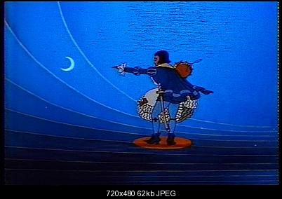

  1. Does anybody know how to filter/smooth this?
    Notice the "noise" in the blue area above their heads. What to do other than hand edit?

  2. Sort of looks like dropouts; you can try the removedirt/dust filters in avisynth
    What is the pattern? Does this occur on 1 frame only or multiple frames?
    What is the distribution? only top half? If so you could limit the filter by overlay
    Maybe a small video sample would help

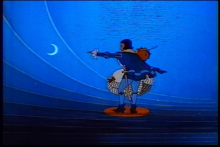

  3. It occurs mainly in the large blue area above their heads, and only in this scene. The rest of the video is clean. Here's an xvid-compressed sample.
    Darryl
  4. any "automatic" filters will destroy the good parts , making them very blurry, and the demarcation isn't a perfect grid (you can't just do a horizontal overlay strip, or you'll cut off pieces like heads)
    to do a good repair you will need some hand work to limit the repair - rotoscoping, masks, maybe with something like after effects would make it easier to do than photoshop

    Was the original source VHS? This looks like classic chroma noise. Difficult to remove without blurring the rest of the picture.
  6. The source is SVHS. I was hoping to fix it without much hand editing. If I make a mask, I can heavily filter the blue area without losing detail. I am just not sure which filter to use.
    Darryl
  7. Your re-encoded /resized sample destroys the relationship of the dirt/dust . If you use the original capture, using removedirt and removedustmc or related functions will get you a clean background on one of the initial frames of that section. With that, you can clone the rest with masks/roto
