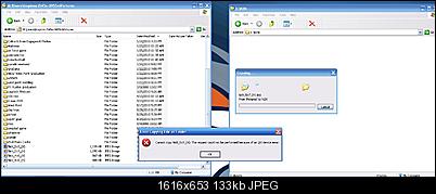

    My inlaws OS drive is dying/died, I have connected the drive to my pc and can see the files that I want to save on the dead drive, but I am unable to move files from the dying drive to my pc. I have tried copying/pasting, tried using recuva (got an I/O error) and also tried using acronis to back up the files, but always get an I/O error
    Here is an snap shot of what I am talking about
Name:	IO Errror.jpg
    Any ideas of how I can get those files off the dying drive? I'm out of ideas
