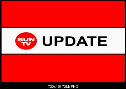

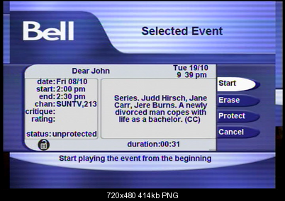

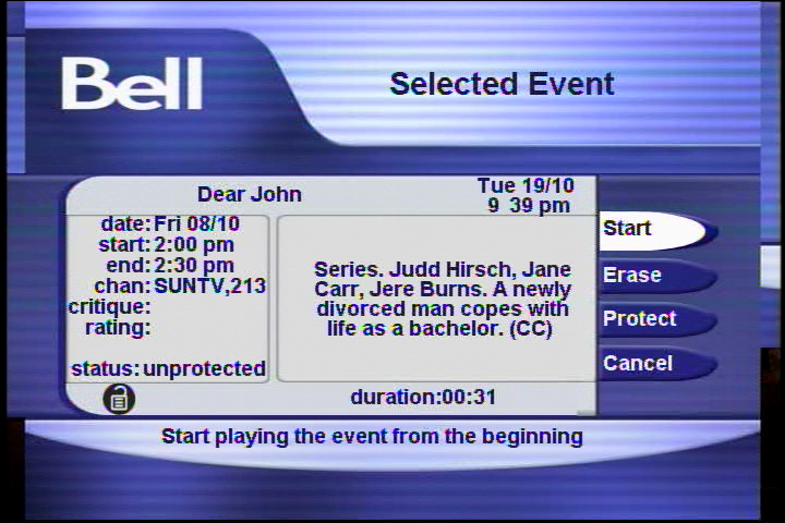

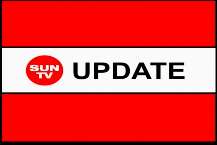

    I decided to try again to see if the analog passthrough would at least work. To my surprise it did this time, and when I looked over at WinDV I saw that it was also previewing the input so I hit Capture.
    I'm pretty pleased with that, though the comb filter leaves something to be desired.

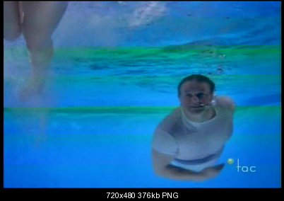

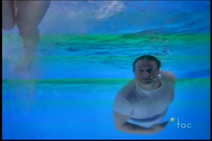

    All well and good, but maybe 5 minutes in I started noticing obnoxious colored bands appearing. When I checked back 40 mins later they were even more noticeable. Their intensity was directly proportional to the color saturation in the image, and they showed up both on the capture and the "passthrough" (actually A-D-A output) signal I was watching.
