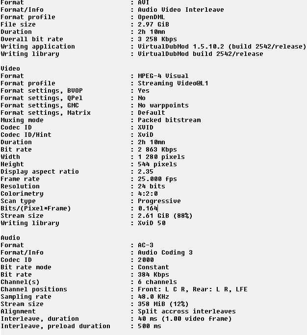

    .... of an avi file to give it Blu Ray like quality. I don't know if it's possible at all but changing the aspect ratio would be fine. I've tried multiAVCHD to convert it to an mkv file but wouldn't play on the usb connection of my LCD. I don't have a BD player otherwise I think I would have been able to burn the folder to BD and play it. I have also tried using XviD4PSP v5.037.8 rev 132 to convert it to a mkv format x264 lossless video encoding and MP3 VBR Q4 audio encoding. After several hours it couldn't complete the job because the file amounted to 80 gb and there was no available space. Through trial and error I have gathered what type of file can play on the LCD but I discovered http://lgusb.wikispaces.com/ that could possibly list what files can be played on the LCD. Incidentally my LCD's firmware is v3.12.07 which I don't know if it's the same as the v3.15 that they talk about on the site. So in conclusion I'm lost and I am seeking options. BTW the file is from an HD DVD (PAL) source and of course I am trying to view it on NSTC. The properties of the file are as follows:

  2. XviD4PSP can do it. Just don't make it lossless. Use CRF 18 or so for very good quality. However, whatever Blu-Ray quality it ever had was already lost in the conversion to an undersized XviD.
  3. That reference indicates the TV supports Xvid in AVI. But if you can't play that video as-is it probably just doesn't support Xvid at HD resolutions. If it does play but the aspect ratio is wrong you can use Mpeg4Modifier to change the aspect ratio without reencoding.

    I appreciate the advice but to clarify the original avi file does play on my LCD just fine. It's when I convert it that the file doesn't play. Also the video has black borders on top and the bottom. I don't know if these conversion processes would eliminate that or perhaps I need to crop somehow.
  5. It's supposed to have black letterbox bars -- like many movies, the video is 2.35:1 and your TV is 1.77:1.
