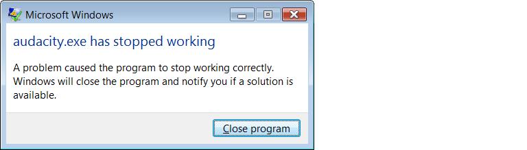

    Actually audacity installs just fine it just won't start. When I double click it it goes through the motions of loading but than windows flashes the "program won't start" message but doesn't give any details or warning messages beyond "won't start".

    No luck. Tried it on both of my internal harddrives no luck. Tried it as run as administrator no luck. Each time I get the same message as above.
    Is it something to do with vista 32bit?

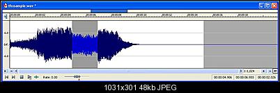

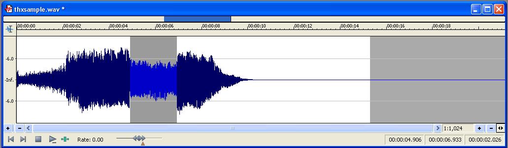

    yoda I looked at your sample in an audio editor, the right channel looks normal,
    while the left appears to flatten slightly for two seconds and then goes back to normal.
    Is this the problem?
    You can certainly convert it to mono - but it doesn't solve the problem, because you get a loss
    of volume at that point (highlighted area)
