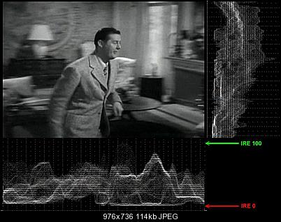

  7. In addition to a histogram, you can also use:
    ColorYUV(Analyze=True)
    Limiter(Show="Luma")
    Red and green are the levels below 16 and above 235, respectively. It'll also show you the max and min luma values and kind of an 'average' max and min value. It's very useful and that's what I use most of the time.

  8. This post:
    https://forum.videohelp.com/threads/326496-file-in-Virtualdub-has-strange-colors-when-o...=1#post2022085
    Has a DV AVI levels video that's useful for calibrating your monitor and testing your work flow.

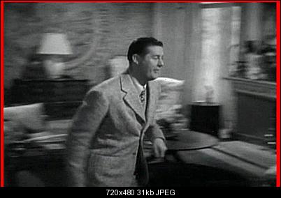

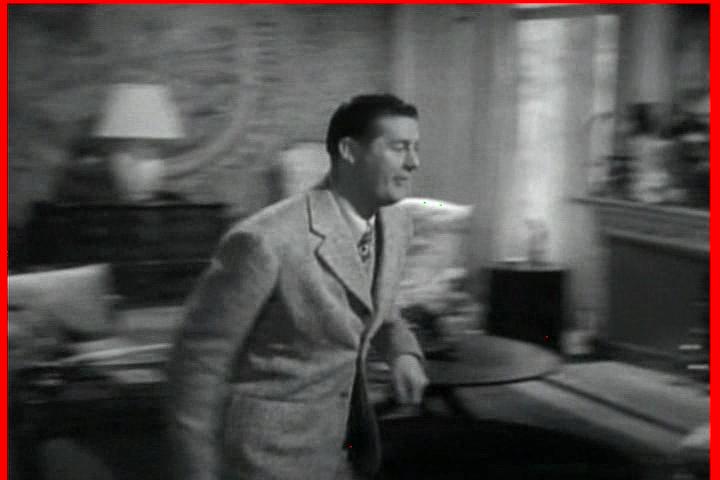

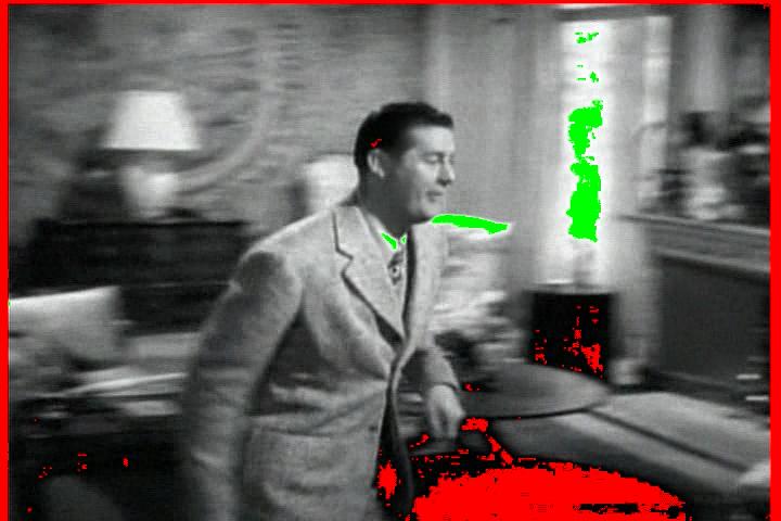

  18. Originally Posted by spiritgumm View Post
    Since this movie is b&w, I'm not seeing any green/red blobs. If I'm suppose to, then something is wrong on my end.
    It doesn't matter that the video is black and white. Limiter(Show="Luma") replaces pixels that are below IRE 0 with red, above IRE 235 with green for easy identification. Your video after too much contrast stretch:
    and after a more reasonable contrast stretch (for this frame):

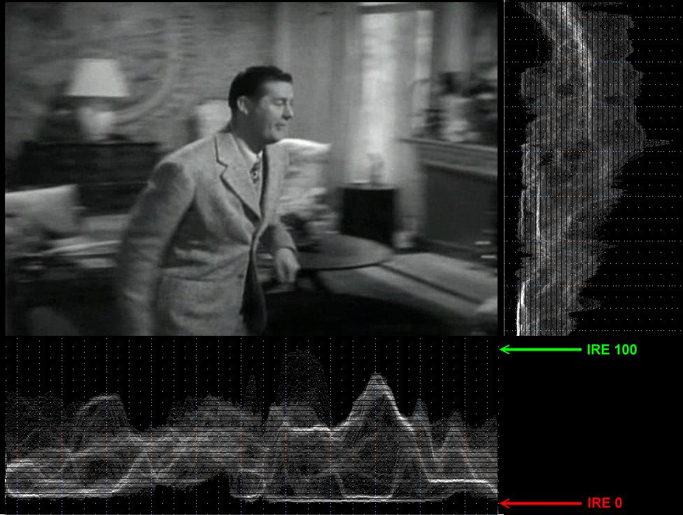

    the second image with VideoScope():

  19. Right, your problem is that all the black in the video isn't black but grey. You want to make it blacker. There isn't any red to be seen. Take down the black levels until you begin to see red. In my script for your sample earlier, my filters brought it down until red dots were begun to be seen. Because Tweak's brightness also messes with the contrast, you'll have to raise it a bit to compensate. I made it how I like it, though. You may or may not want a similar 'look'.
    I think jagabo works mostly with ColorYUV and the histogram. Just learn to work with whatever suits you.
  20. Originally Posted by manono View Post
    I usually use ColorYUV() and VideoScope() for levels adjustment. But that's just a personal preference.
