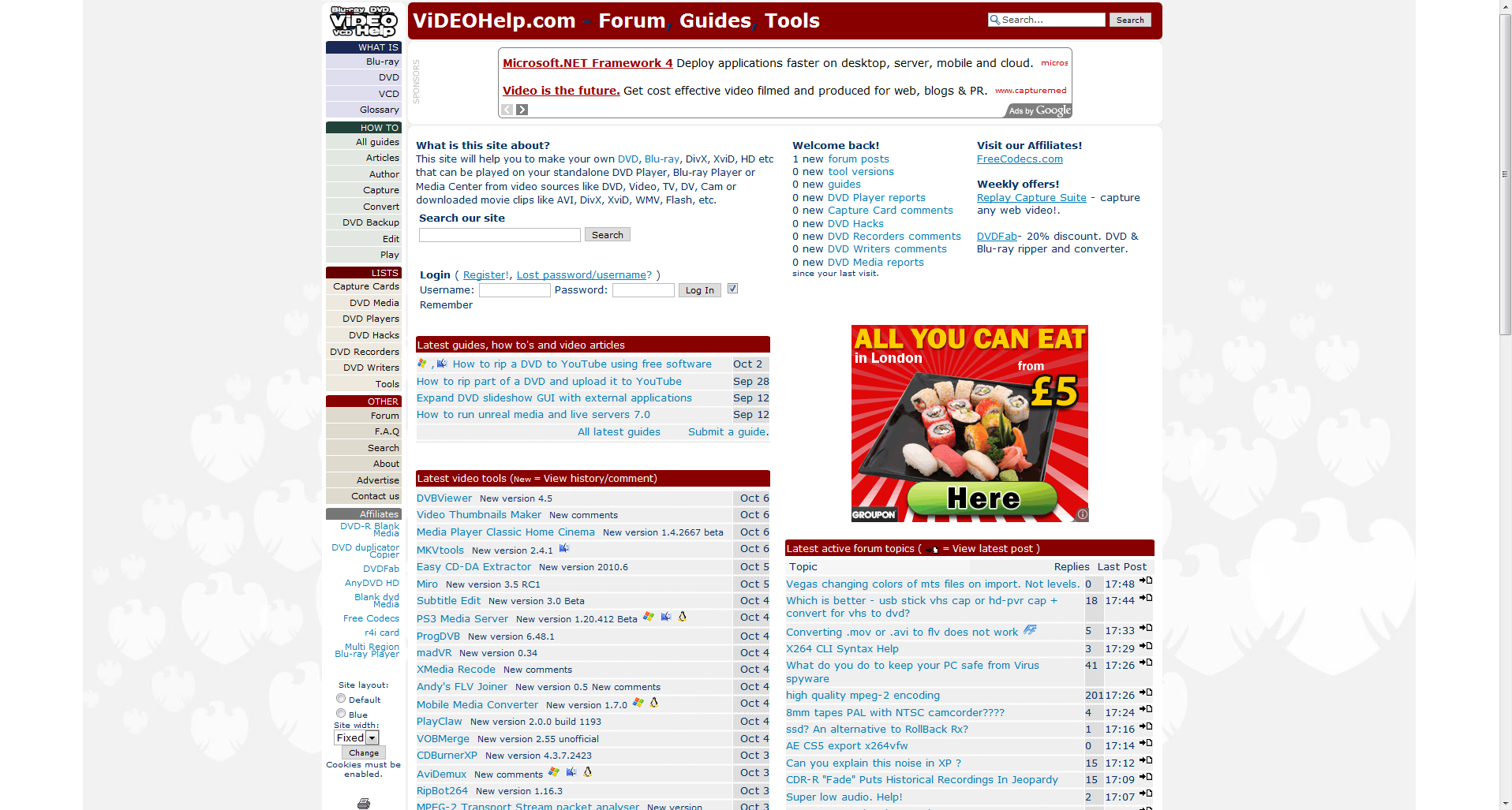

    Whenever i load a page through IE i get the background image as per the screenshot i have uploaded. Scanning of system as not brought anything up as yet. Has anyone seen this before? Many Thanks

  2. Member hech54's Avatar
    "Scanning" with what exactly?
  3. Member ranchhand's Avatar
    Oct 2005
    USA-midwest
    Looks like you have a custom wallpaper enabled; if you are running XP R-click the desktop, Properties, Desktop and see what background is enabled.
  4. your browser background is setup as white. change it in settings
    Feb 2004
    Australia
    A: Ie > Tools > Internet options > Advanced > Reset.
    B: Also check temporary internet folder location and clean it out.
    It's most likely related to one of a number of css bugs which affect ie and ie has somehow locked into the idea of displaying the image which is why you do A and B then try again.

  7. Browser as supplied by Barclays bank? thats their Logo

  8. Member lacywest's Avatar
    Aug 2001
    California
    Try un-installing IE8 and installing IE7 ... you could download a fresh IE8 from somewhere reputable.
    Jan 2004
    Thanks everyone but i have managed to clear out the infected part. It was some malware that auto-installed itself; i dont recall the exact page i was on at the time (clearly it was a suspect one). All i recall is that Java updater came up and would not close.
    AVG, Adaware & superantispyware scanning all failed to find it. Malwarebytes picked it up within first couple of mins of scanning. Hats off to them.
    Malware log is below:
