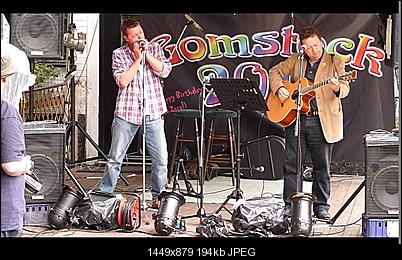

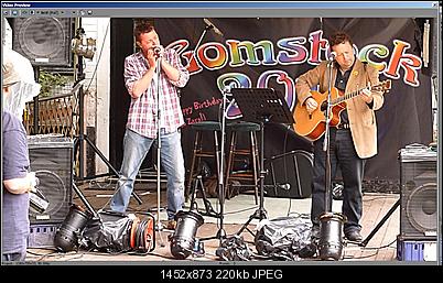

    I have an mts source file from a TZ7 camera. When I open the file in Vegas 9 Pro, it changes the colors slightly, expecially skin tones. Its not a levels issue. I've attached two pics to illustrate. This is simply opening the file in vegas - no processing at all. When rendering the file out of vegas, these color changes are carried forward into the finished render. Anybody got a clue what's happening?
    Cheers!

  2. rec.709 vs rec.601 color? Doesn't look that big though.
  3. Yes I think its to do with bt.601 vs bt.709. I think the source is bt.601 but Vegas thinks its bt.709, so soon as you import it, the color shift happens. Can't find a way round this at the moment. Yes its not a massive change, but would like to get in control of it...
  4. You cannot control vegas' Y'CbCr => RGB conversion to use bt.601 vs. bt.709
    You can either convert to RGB using bt.601 (e.g. in avisynth) to a lossless RGB intermediate for import
    or export uncompressed RGB AVI then convert bt.709 => bt.601 using aviysnth colormatrix filter (then encode to your final format goal)
  5. I AviSynth use the ColorMatrix() filter:
    ColorMatrix(mode="Rec.709->Rec.601")
    or
    ColorMatrix(mode="Rec.601->Rec.709")
    Whichever way you need to go.

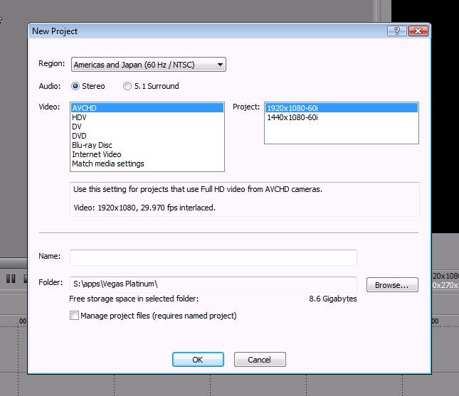

    FWIW - Just installed a copy of Vegas Movie Studio Platinum 10. Unlike Vegas Pro9 it does have an AVCHD project setting but AVCHD Lite is not included.
    This consumer product defines the project in terms of output format. Alternately "Match Media Settings" seems to set project to source format. More later as I play with it.

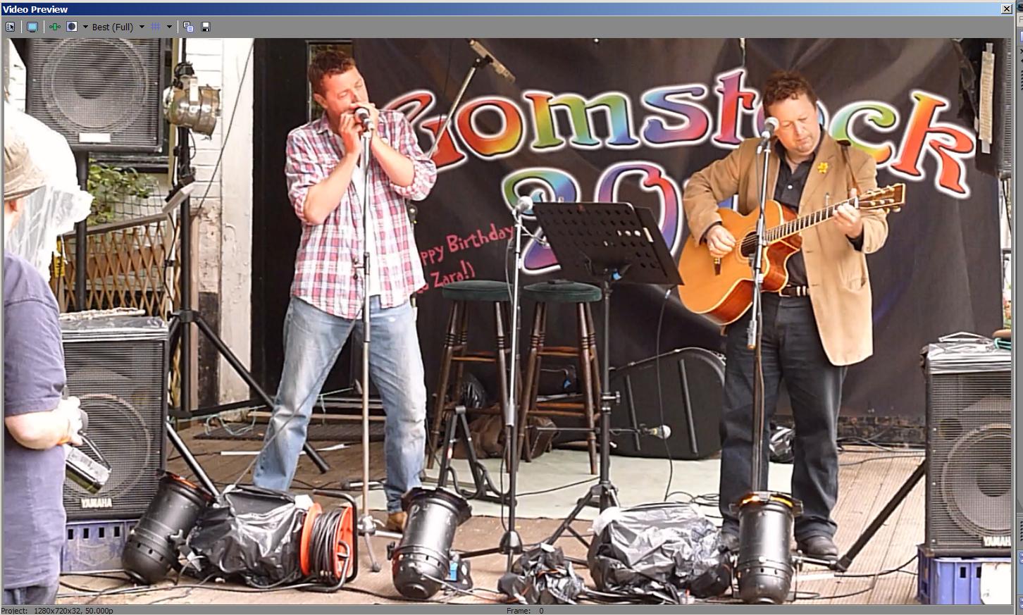

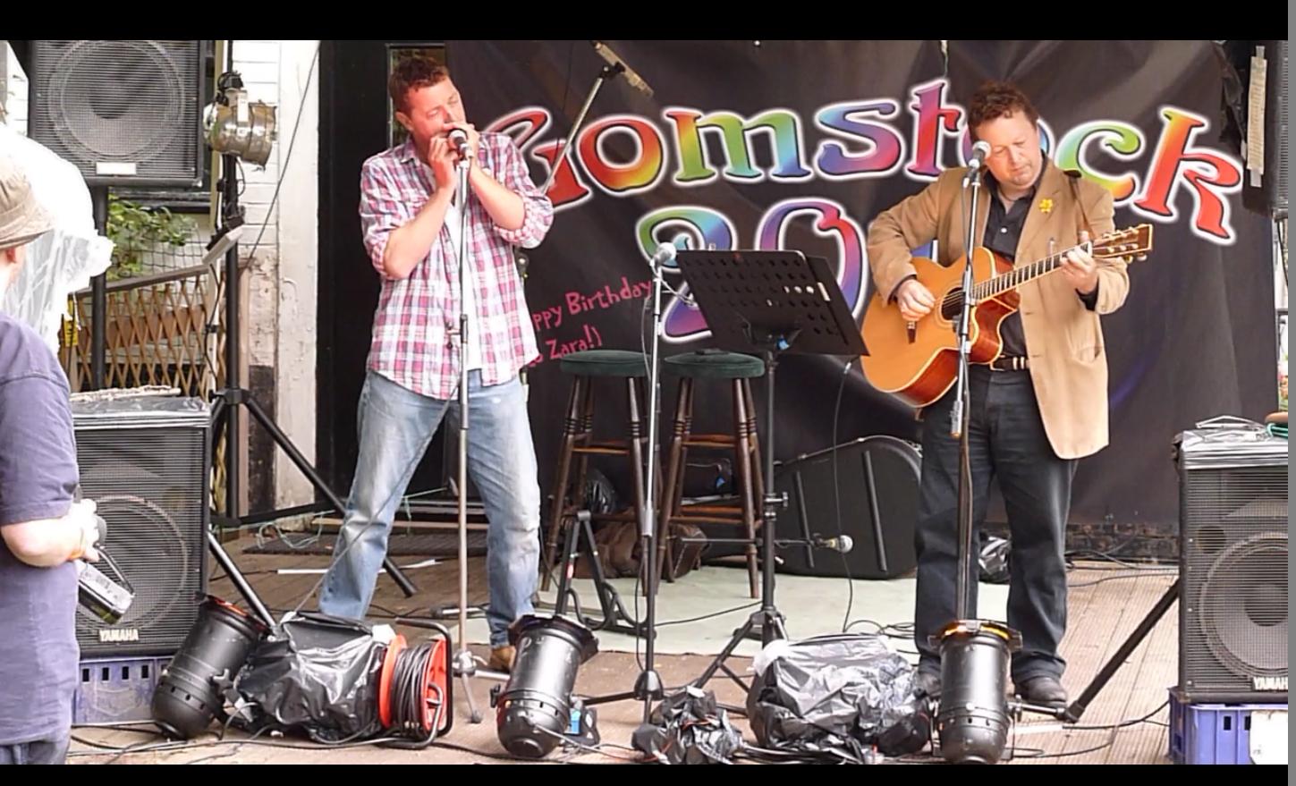

  28. @edDV - I tried a whole bunch of different project templates and settings, and unfortunately it was the same result when importing the mts files. I think vegas is doing its thing with mts files as a matter of course, no matter what your project settings are.
    @poisondeathray - thanks for the headsup on avfs, I'll give it a go. I also found vfapi that will create a dummy avi to feed into vegas. This seems to work as well. Is either of these methods (avfs or vfapi) destructive in any way, or purely a wrapper?
    The first pic above is the mts file decoded with CoreAVC using yv12. Using bt.601 by the sounds of what you say. If I make CoreAVC use rgb rather than yv12 and force bt.709, it looks exactly the same as the mts file imported straight into vegas, so that actually all makes sense. I deduce from this that CoreAVC is actually using the wrong color matrix in yv12 mode. Subjectively, I think this looks more natural than when I force it to bt.709, but like you say, that's another topic...
