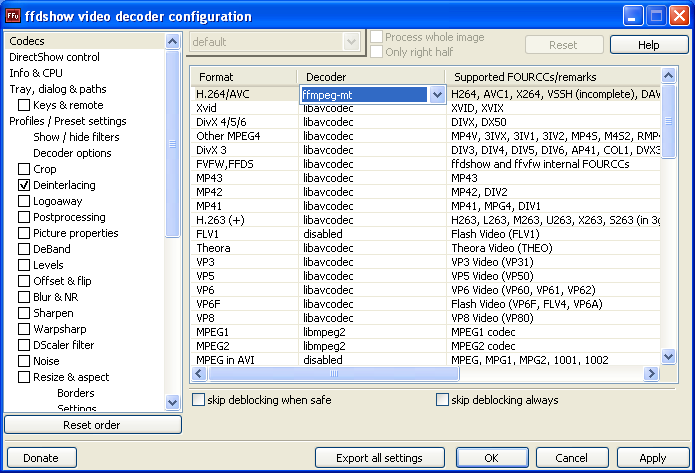

  9. MPC
    FFmpeg settings
    Decoding thread number:4
    H264 skip deblocking mode: Default
    DXVA Mode: Not using DXVA

    I'm trying to understand what happened here. When MPCHC is using its own H264/AVC (ffmpeg) I get the best results.

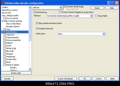

  19. Click image for larger version
ID:	3763Click image for larger version

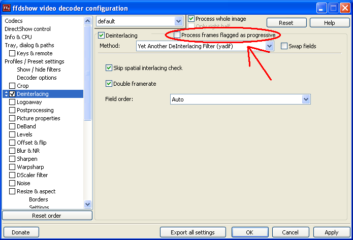

  20. Try turnung off deinterlacing.

  22. Don't turn off Deinterlacing, ffdshow recognizes if the video-file is interlaced or progressive. (-> Flag also MediaInfo reads).
    So ffdshow only deinterlaces when necessary. Trust Me, I know what I'm talking about

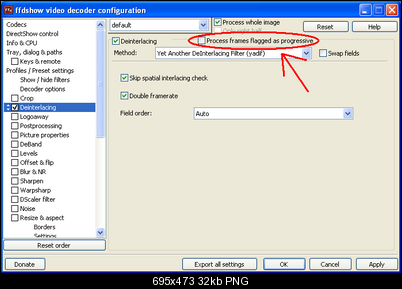

  23. you can force ffdshow to deinterlace progressive-flagges filesClick image for larger version
  24. You should never do it. But if the file is interlaced and flagged as progressive you should do it
  25. Member
    Aug 2002
    Only reason to deinterlace progressive flagged frames would be if they were truly interlaced but encoded as progressive.
    60p is already progressive so why would it help to enable that option?
    I would reencode it to 720p so I can get DXVA with 60 fps.

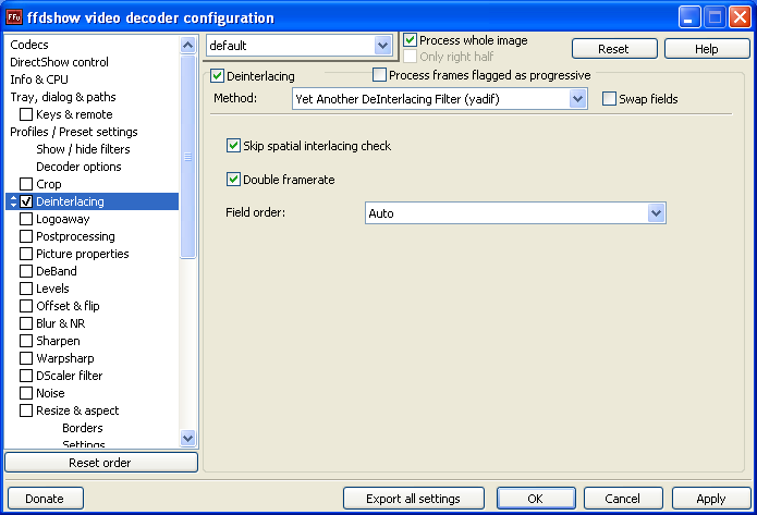

    ... and by the way, the deinterlacing settings are very good for interlaced DVDs in MPC HC.
    Just prefer ffdshow in MPC HC for everything, test it before you say my setting are crap!!!

  28. @ jagabo: A CX520 or a CX550 is about the same price
    AND
    my settings in ffdshow and MPC HC work very good and ffdshow doesn't deinterlace the progressive encoded and as progressive flagged video-files of the panasonic
    That means that my settings are correct, isn't it?
  29. Yes your settings are correct. Maybe the OPs files arent' correct. Maybe they're marked interlaced. Maybe ffdshow is just confused by the 1920x1080p60 file. It safest to turn off deinterlacing just to be sure. Then if that works then he can go back to see why deinterlacing wasn't working.
  30. When I watch a DVD (prgressive video in interlaced container, strange huh?) with these settings in ffdshow and MPC HC, then ffdshow doesn't deinterlace the DVD, because it not only looks to the flags, it also looks the video directly. For example the Rockford-DVDs are progressive and marked as interlaced, so vlc deinterlaces the DVD when set to auto, ffdshow doesn't... I don't know why...
